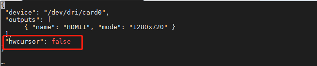

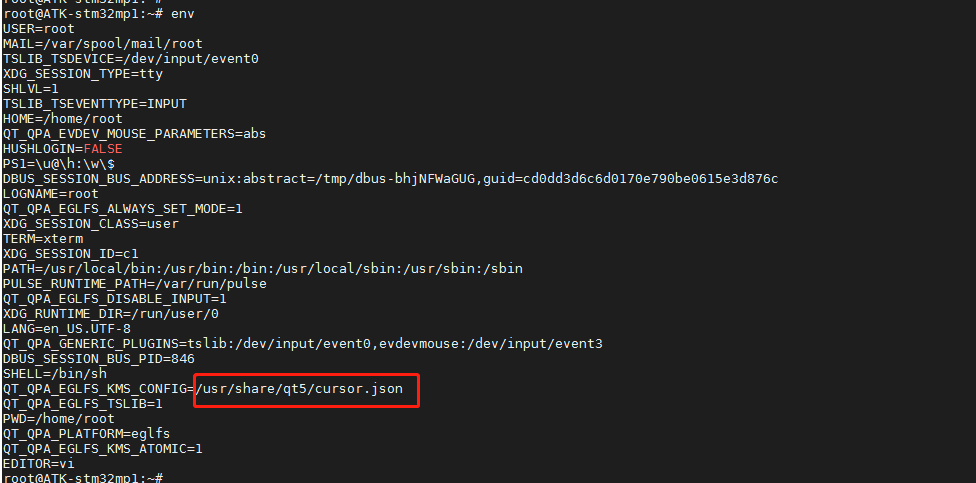

Qt uses 'eglfs' to display. After configuring this 'hwcursor', use Qt to display the card on HDMI. The touch screen will also get stuck.

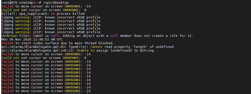

When the QT_QPA_GENERIC_PLUGINS environment variable is deleted and the mouse is plugged in, the mouse cannot be displayed on the Qt interface, and the mouse can be used, and the use of 'hdmi' or LCD is very smooth. The terminal keeps printing "Failed to move cursor on screen UNKNOWN1: -14", as shown below.

I compiled according to St Yocto and used version 3.1.I don't use Wayland, I use EGLFS.But Qt uses EGLFS more slowly than Wayland does, and the mouse moves slowly across the screen.Using Qt version is 5.14.1.
