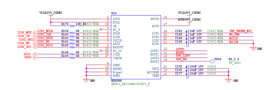

Hi ST Team,
We have developed a board based on the STM32MP257F. Currently, I am focusing on the audio section. We use an I2S port to connect to a codec called ES8388 chip. You can find the schematic in the attached picture,
the connection between ES8388 and STM32MP25 like the following path,
I2S2_MCK --- PI15
I2S2_CK    --- PB0
I2S2_SDO --  PK1
I2S2_WS ---   PI14
I2S2_SDI ---   PB6

I rebuilt the kernel and download it to board, I can recognized the audio card by using "aplay -l" command and also can play audio with rate 16000Hz,
root@stm32mp2:~# aplay test1.wav
Playing WAVE 'test1.wav' : Signed 16 bit Little Endian, Rate 16000 Hz, Mono
but when I play one audio with rate 22050Hz, the error occured,
root@stm32mp2:~# aplay test2.wav
Playing WAVE 'test2.wav' : Signed 16 bit Little Endian, Rate 22050 Hz, Mono
[  198.334255] st,stm32-i2s 400b0000.audio-controller: Failed to find an accurate rate
[  198.336312] st,stm32-i2s 400b0000.audio-controller: ASoC: error at snd_soc_dai_set_sysclk on 400b0000.audio-controller: -22
[  198.347840]  400b0000.audio-controller-es8328-hifi-analog: ASoC: error at snd_soc_link_hw_params on 400b0000.audio-controller-es8328-hifi-analog: -22
[  198.361021]  400b0000.audio-controller-es8328-hifi-analog: ASoC: error at __soc_pcm_hw_params on 400b0000.audio-controller-es8328-hifi-analog: -22
[  203.384524] st,stm32-i2s 400b0000.audio-controller: Failed to find an accurate rate
[  203.386627] st,stm32-i2s 400b0000.audio-controller: ASoC: error at snd_soc_dai_set_sysclk on 400b0000.audio-controller: -22
[  203.398530]  400b0000.audio-controller-es8328-hifi-analog: ASoC: error at snd_soc_link_hw_params on 400b0000.audio-controller-es8328-hifi-analog: -22
[  203.411318]  400b0000.audio-controller-es8328-hifi-analog: ASoC: error at __soc_pcm_hw_params on 400b0000.audio-controller-es8328-hifi-analog: -22
and rate 44100hz also has error,
root@stm32mp2:~# aplay test3.wav
Playing WAVE 'test3.wav' : Signed 16 bit Little Endian, Rate 44100 Hz, Mono
[  132.343536] st,stm32-i2s 400b0000.audio-controller: Failed to find an accurate rate
[  132.345630] st,stm32-i2s 400b0000.audio-controller: ASoC: error at snd_soc_dai_set_sysclk on 400b0000.audio-controller: -22
[  132.356832]  400b0000.audio-controller-es8328-hifi-analog: ASoC: error at snd_soc_link_hw_params on 400b0000.audio-controller-es8328-hifi-analog: -22
[  132.370390]  400b0000.audio-controller-es8328-hifi-analog: ASoC: error at __soc_pcm_hw_params on 400b0000.audio-controller-es8328-hifi-analog: -22
[  137.389972] st,stm32-i2s 400b0000.audio-controller: Failed to find an accurate rate
[  137.392105] st,stm32-i2s 400b0000.audio-controller: ASoC: error at snd_soc_dai_set_sysclk on 400b0000.audio-controller: -22
[  137.403519]  400b0000.audio-controller-es8328-hifi-analog: ASoC: error at snd_soc_link_hw_params on 400b0000.audio-controller-es8328-hifi-analog: -22
[  137.416918]  400b0000.audio-controller-es8328-hifi-analog: ASoC: error at __soc_pcm_hw_params on 400b0000.audio-controller-es8328-hifi-analog: -22
Can someone help check what happened? Did I miss something?
