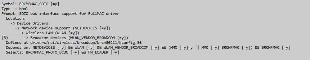

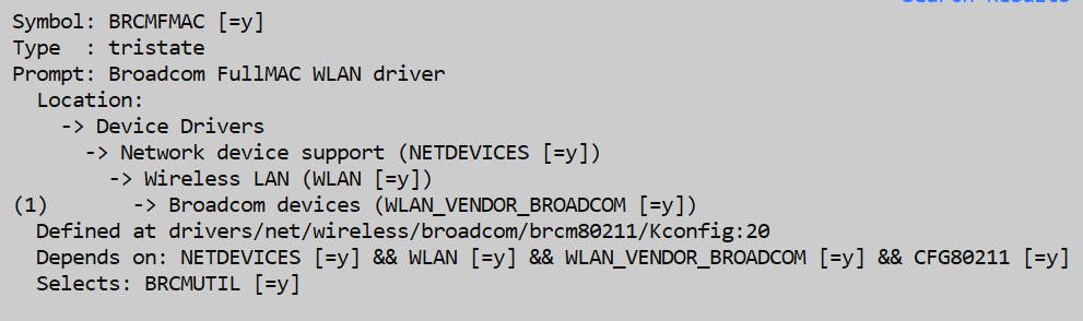

for the On-Chip wifi module of the STM32MP157c-dk2 you must enable the broadcom FullMAC WLAN driver and its SDIO bus interface (the brcmfmac module is used) in the linux-menuconfig.
In buildroot you have to activate the 'Broadcom BRCM bcm43xx' firmware at Target packages -> Hardware handling -> Firmware -> linux firmware -> Wifi firmware. Also you will need a .txt file to load the firmware. I got this one from the ST Starter Package cause it is not available in the buildroot package. Just search for 'brcmfmac43430-sdio.txt'. I tried this one (https://raw.githubusercontent.com/RPi-Distro/firmware-nonfree/master/brcm/brcmfmac43430-sdio.txt) too wich worked as well, I did not test it though. You will see in the dmesg which .txt file is needed.

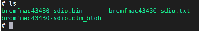

It goes to /lib/firmware/brcm on your target after building (you can use the buildroot overlay function for example). Buildroot will also copy the bcrm firmware to that folder, be sure to enable it, too.

for the driver I
1- git clone git://github.com/murata-wireless/cyw-fmac-fw.git;protocol=https;nobranch=1;name=murata;destsuffix=murata
2- git checkout -b 8d87950bfad28c65926695b7357bd8995b60016a
3- got the .txt file from: https://github.com/STMicroelectronics/meta-st-stm32mp/blob/dunfell/recipes-kernel/linux-firmware/linux-firmware/brcmfmac43430-sdio.txt?fbclid=IwAR1KtSo4XzA8mV_tbL9ERkdBMduSwtbBed66_5tMDpq5D_wpFy69FSClC_s
4 - my brcm directory on my target device (STM32MP157C-DK2) looks like in the photo I uploaded
0693W000005B06LQAS.pngI don't know what is not working here.
I can share my interfaces and wpa_supplicant files. Maybe there is a fault there but I don't thing so.

Thank you @Lukas Brückner​  for the detailed troubleshooting steps. I tried the above steps and also still cannot get WiFi working on the STM32MP157-DK2 with Buildroot. I think perhaps I got 1 step farther than SigmaPrime because my error changed from
Successfully initialized wpa_supplicant
nl80211: 'nl80211' generic netlink not found
Failed to initialize driver 'nl80211'
wlan0: Unsupported driver 'nl80211'
To:
# wpa_supplicant -B -i wlan0 -W -D nl80211, wext -c /etc/wpa_supplicant.conf
Could not read interface wlan0 flags: No such device
nl80211: Driver does not support authentication/association or connect commands
nl80211: deinit ifname=wlan0 disabled_11b_rates=0
wlan0: Unsupported driver ''
This change happened after I turned on 80211 support on the linux-menuconfig of Buildroot
There's not much in the DTS or DTSI that mentions wifi (unlike ethernet that has all it's pins mapped). Could this be an issue?

Besides the device tree and the above mentioned device drivers I can share my Network support -> Wireless settings (see picture).
