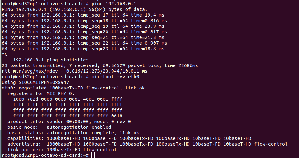

I also installed net-tools
and typing
mii-tool -vv eth0
I receive something
0693W00000GXnQDQA1.pngSo I'm not able to read PHY ID.
From the documentation, I read that ID is 0007.C0D1. This ID is identical to LAN911x.
MWoło.2
MWoło.2Author
Senior III
November 16, 2021
I have a strange feeling that I configured everything good and a problem is related to configuration DSA(switch) into systemd.
My current boot log looks
[  0.000000] psci: probing for conduit method from DT.
[  1.519995] usbcore: registered new interface driver cdc_ether
[  2.824784] stm32-dwmac 5800a000.ethernet: IRQ eth_lpi not found
[  2.829640] stm32-dwmac 5800a000.ethernet: PTP uses main clock
[  2.835410] stm32-dwmac 5800a000.ethernet: no reset control found
[  2.842036] stm32-dwmac 5800a000.ethernet: User ID: 0x40, Synopsys ID: 0x42
[  2.848625] stm32-dwmac 5800a000.ethernet:  DWMAC4/5
[  2.853614] stm32-dwmac 5800a000.ethernet: DMA HW capability register supported
[  2.860968] stm32-dwmac 5800a000.ethernet: RX Checksum Offload Engine supported
[  2.868399] stm32-dwmac 5800a000.ethernet: TX Checksum insertion supported
[  2.875361] stm32-dwmac 5800a000.ethernet: Wake-Up On Lan supported
[  2.881819] stm32-dwmac 5800a000.ethernet: TSO supported
[  2.887104] stm32-dwmac 5800a000.ethernet: Enable RX Mitigation via HW Watchdog Timer
[  2.895042] stm32-dwmac 5800a000.ethernet: device MAC address a2:6d:9e:38:f7:a6
[  2.902415] stm32-dwmac 5800a000.ethernet: Enabled Flow TC (entries=2)
[  2.909062] stm32-dwmac 5800a000.ethernet: TSO feature enabled
[  2.914958] stm32-dwmac 5800a000.ethernet: Using 32 bits DMA width
[  51.958489] using random self ethernet address
[  51.961564] using random host ethernet address
[  53.374605] stm32-dwmac 5800a000.ethernet eth0: PHY [stmmac-0:01] driver [SMSC LAN8710/LAN8720] (irq=52)
[  53.437576] stm32-dwmac 5800a000.ethernet eth0: No Safety Features support found
[  53.485457] stm32-dwmac 5800a000.ethernet eth0: IEEE 1588-2008 Advanced Timestamp supported
[  53.500961] stm32-dwmac 5800a000.ethernet eth0: registered PTP clock
[  53.547373] stm32-dwmac 5800a000.ethernet eth0: configuring for phy/rmii link mode
[  53.584953] 8021q: adding VLAN 0 to HW filter on device eth0
[  53.600653] stm32-dwmac 5800a000.ethernet eth0: Adding VLAN ID 0 is not supported
The eth0 is combined somehow with VLAN. Unfortunately, I haven't enough knowledge of how to do this.
Can someone give me some links to, manual on how to do this in systems, not in busybox.
Thanks

my log is
[  2.969615] libphy: stmmac: probed
[  2.984053] LAN9303_MDIO stmmac-0:00: Found LAN9303 rev. 1
[  3.249640] LAN9303_MDIO stmmac-0:00: Found LAN9303 rev. 1
[  3.321255] LAN9303_MDIO stmmac-0:00: Using legacy PHYLIB callbacks. Please migrate to PHYLINK!
[  3.340418] LAN9303_MDIO stmmac-0:00 lan1 (uninitialized): PHY [dsa-0.0:01] driver [SMSC LAN911x Internal PHY] (irq=POLL)
[  3.354287] LAN9303_MDIO stmmac-0:00 lan2 (uninitialized): PHY [dsa-0.0:02] driver [SMSC LAN911x Internal PHY] (irq=POLL)
[  3.367043] LAN9303_MDIO stmmac-0:00: LAN9303 MDIO driver loaded successfully
[  54.013139] stm32-dwmac 5800a000.ethernet eth0: PHY [stmmac-0:01] driver [SMSC LAN911x Internal PHY] (irq=52)
[  56.055846] LAN9303_MDIO stmmac-0:00 lan1: configuring for phy/gmii link mode
[  56.374405] LAN9303_MDIO stmmac-0:00 lan2: configuring for phy/gmii link mode
[ 100.075252] LAN9303_MDIO stmmac-0:00 lan2: Link is Up - 100Mbps/Full - flow control rx/tx
[ 134.085231] LAN9303_MDIO stmmac-0:00 lan1: Link is Up - 100Mbps/Full - flow control rx/tx
[ 168.715032] LAN9303_MDIO stmmac-0:00 lan2: Link is Down
[ 169.435065] LAN9303_MDIO stmmac-0:00 lan1: Link is Down
and everything seems to be work but I have a problem with VLAN filtering
[  54.130459] 8021q: adding VLAN 0 to HW filter on device eth0
[  54.130514] stm32-dwmac 5800a000.ethernet eth0: Adding VLAN ID 0 is not supported
[ 100.082137] IPv6: ADDRCONF(NETDEV_CHANGE): lan2: link becomes ready
[ 134.092101] IPv6: ADDRCONF(NETDEV_CHANGE): lan1: link becomes ready
[ 145.520560] stm32-dwmac 5800a000.ethernet eth0: Link is Up - 100Mbps/Full - flow control rx/tx
[ 145.528055] IPv6: ADDRCONF(NETDEV_CHANGE): eth0: link becomes ready
[ 147.737539] net eth0: Dropping packet due to invalid VLAN marker
[ 147.742227] net eth0: Dropping packet due to invalid VLAN marker
[ 147.754183] net eth0: Dropping packet due to invalid VLAN marker
[ 147.758863] net eth0: Dropping packet due to invalid VLAN marker
[ 150.928970] net eth0: Dropping packet due to invalid VLAN marker
[ 150.933682] net eth0: Dropping packet due to invalid VLAN marker
[ 150.939763] net eth0: Dropping packet due to invalid VLAN marker
[ 150.945837] net eth0: Dropping packet due to invalid VLAN marker
[ 151.102514] net eth0: Dropping packet due to invalid VLAN marker
[ 151.107207] net eth0: Dropping packet due to invalid VLAN marker
[ 152.765556] lan9303_rcv: 6 callbacks suppressed
[ 152.768763] net eth0: Dropping packet due to invalid VLAN marker
[ 152.774845] net eth0: Dropping packet due to invalid VLAN marker
[ 152.781109] net eth0: Dropping packet due to invalid VLAN marker
[ 152.787024] net eth0: Dropping packet due to invalid VLAN marker
[ 152.793150] net eth0: Dropping packet due to invalid VLAN marker
[ 152.799229] net eth0: Dropping packet due to invalid VLAN marker
[ 153.417139] net eth0: Dropping packet due to invalid VLAN marker
[ 153.421823] net eth0: Dropping packet due to invalid VLAN marker
[ 153.432334] net eth0: Dropping packet due to invalid VLAN marker
[ 153.437043] net eth0: Dropping packet due to invalid VLAN marker
[ 161.525183] lan9303_rcv: 8 callbacks suppressed
[ 161.528379] net eth0: Dropping packet due to invalid VLAN marker
[ 161.534468] net eth0: Dropping packet due to invalid VLAN marker
[ 161.540766] net eth0: Dropping packet due to invalid VLAN marker
[ 161.546639] net eth0: Dropping packet due to invalid VLAN marker
[ 161.552685] net eth0: Dropping packet due to invalid VLAN marker
[ 161.558848] net eth0: Dropping packet due to invalid VLAN marker
[ 161.564941] net eth0: Dropping packet due to invalid VLAN marker
[ 161.570962] net eth0: Dropping packet due to invalid VLAN marker
[ 164.017030] net eth0: Dropping packet due to invalid VLAN marker
[ 164.021672] net eth0: Dropping packet due to invalid VLAN marker
[ 169.027536] lan9303_rcv: 6 callbacks suppressed
[ 169.030707] net eth0: Dropping packet due to invalid VLAN marker
[ 169.040067] net eth0: Dropping packet due to invalid VLAN marker
[ 175.675825] stm32-dwmac 5800a000.ethernet eth0: Link is Down
Unfortunately, I have no idea what this VLAN means. I read that LAN9303 do not support filtering but how to disable or work around this. guess that for this reason, I have not received an IP address.
Ref.
https://01.org/linuxgraphics/gfx-docs/drm/networking/dsa/lan9303.html
MWoło.2
MWoło.2Author
Senior III
November 20, 2021
VLAN warning removed by disabled options in the Kernel.
MWoło.2
MWoło.2AuthorBest answer
Senior III
November 22, 2021
DSA switch works. For my purpose, I don't need to add a LAN9303 driver. Just LAN911x is sufficient enough. Finally, I understand that this switch works like a daisy chain connection. The conclusion is
