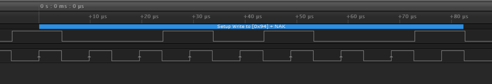

when setting audio via I2C1, I always got NACK on the bus. I have checked AD0=0 , and guess it is the audio codec not ready, how can I resolve this issue?
AUDIO_I2C_ADDRESS= 0x94
void AUDIO_IO_Init(void)
  GPIO_InitTypeDef  GPIO_InitStruct;
  uint8_t Value, ret;
  /* Enable Reset GPIO Clock */
  AUDIO_RESET_GPIO_CLK_ENABLE();
  /* Audio reset pin configuration */
  GPIO_InitStruct.Pin   = AUDIO_RESET_PIN;
  GPIO_InitStruct.Mode  = GPIO_MODE_OUTPUT_PP;
  GPIO_InitStruct.Speed = GPIO_SPEED_FREQ_HIGH;
  GPIO_InitStruct.Pull  = GPIO_PULLUP;//GPIO_NOPULL;
  HAL_GPIO_Init(AUDIO_RESET_GPIO, &GPIO_InitStruct);
//OK
  /* I2C bus init */
  I2C1_Init();
  /* Power off the codec */
  CODEC_AUDIO_POWER_OFF();
  ret = HAL_GPIO_ReadPin(GPIOG, GPIO_PIN_9);
  printf("ret1= %d\n",ret);
  /* wait until power supplies are stable */
  HAL_Delay(10);
  /* Power on the codec */
  CODEC_AUDIO_POWER_ON();
  printf("ret2= %d\n",ret);
//  if(HAL_I2C_IsDeviceReady(&I2c1Handle, AUDIO_I2C_ADDRESS, 3, 3000)!=HAL_OK){
//	  printf("device not ready!\n\n");
  /* Set the device in standby mode */
  Value = AUDIO_IO_Read(AUDIO_I2C_ADDRESS, 0x02);
  AUDIO_IO_Write(AUDIO_I2C_ADDRESS, 0x02, (Value | 0x01));
  /* Set all power down bits to 1 */
  AUDIO_IO_Write(AUDIO_I2C_ADDRESS, 0x02, 0x7F);
  Value = AUDIO_IO_Read(AUDIO_I2C_ADDRESS, 0x03);
  AUDIO_IO_Write(AUDIO_I2C_ADDRESS, 0x03, (Value | 0x0E));
Thanks
