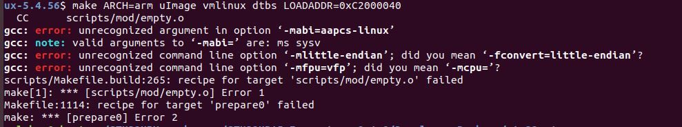

Sisyphus38
November 12, 2020
Next issue......
when running make ARCH=arm uImage vmlinux dtbs LOADADDR=0xC2000040
 WRAP   arch/arm/include/generated/asm/trace_clock.h
 WRAP   arch/arm/include/generated/asm/simd.h
 UPD    include/config/kernel.release
 UPD    include/generated/uapi/linux/version.h
 UPD    include/generated/utsrelease.h
 SYSNR  arch/arm/include/generated/asm/unistd-nr.h
 GEN    arch/arm/include/generated/asm/mach-types.h
 SYSTBL arch/arm/include/generated/calls-oabi.S
 SYSTBL arch/arm/include/generated/calls-eabi.S
 CC     scripts/mod/empty.o
gcc: error: unrecognized argument in option ‘-mabi=aapcs-linux’
gcc: note: valid arguments to ‘-mabi=’ are: ms sysv
gcc: error: unrecognized command line option ‘-mlittle-endian’; did you mean ‘-fconvert=little-endian’?
gcc: error: unrecognized command line option ‘-mfpu=vfp’; did you mean ‘-mcpu=’?
scripts/Makefile.build:265: recipe for target 'scripts/mod/empty.o' failed
make[1]: *** [scripts/mod/empty.o] Error 1
Makefile:1110: recipe for target 'prepare0' failed
make: *** [prepare0] Error 2
Thank you by advance for any help.
Sisyphus38
November 13, 2020
Some think completely broke my SDK install.
The "Hello World" does'nt compile any more.
$CC --version -> unknown command
echo $CROSS_COMPILE -> gives empty string.
I will reinstall the SDK and give you feedback.
Regards
Olivier GALLIEN
Olivier GALLIENBest answer
November 13, 2020
Hi @Sisyphus38​
Open a new shell and source again the SDK.
If one of my comments answer your need, please mark it "Best answer"
Olivier
Olivier GALLIEN In order to give better visibility on the answered topics, please click on 'Accept as Solution' on the reply which solved your issue or answered your question.
Sisyphus38
November 13, 2020
Hello Olivier,
You right. When I source again all env variables are retrieved and the "Hello world" compile again !
I launched make ARCH=arm uImage vmlinux dtbs LOADADDR=0xC2000040 and compiling is still proceeding .
Good signal !
Thank you again Olivier.
