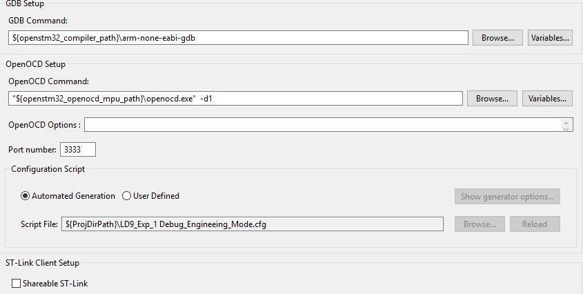

Can't Debug in Engineering Mode using STM32MP157-DK2. OpenOCD Error: Could not find MEM-AP to control the core

Trying to create a simple application that will toggle LD9 in Engineering Mode but get an error with the OpenOCD.

AntonioST
July 17, 2019
In Engineering mode, OpenOCD should be run setting the variable "ENG_MODE" to examine the Cortex-M.
This is already done by the IDE.
Running OpenOCD from the command line, use:
openocd -c 'set ENG_MODE 1' -f board/stm32mp15x_dk2.cfg
BMcCa.3
BMcCa.3Author
July 17, 2019
​Hi Antonio.
I am using the IDE using the default settings.
The Script File does inevitably load the …_dk2.cfg file.
I want to test using the command line.  How do I do this? With the "Command Shell Console" using local settings?
BMcCa.3
BMcCa.3Author
July 17, 2019
