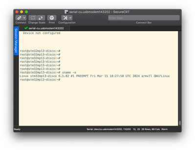

This is my first time to fully build the Distribution Package according to the guide on ST Wiki, and I have gained a lot from it.
But now I have a question to ask for help. After I burned the generated image after the complete build, I found that the compilation date obtained by the uname -a command was incorrect. It was not around the current date, but Fri Mar 15 18:27:50 UTC 2024. What is the reason? I did not modify any code in this process. I think the build is to fully compile all components including the kernel. I hope to get an answer.

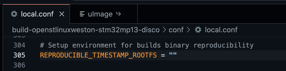

I roughly understand what you mean, it sounds very reasonable, especially for checking the kernel version through the uname command. I found a similar question on the Internet:
:backhand_index_pointing_right:https://adaptivesupport.amd.com/s/article/76559?language=en_US:backhand_index_pointing_left:
And I found the REPRODUCIBLE_TIMESTAMP_ROOTFS keyword under my Yocto build path. I want to determine whether the value of this keyword affects the compilation time obtained by my uname, and I found that not only the compilation time of uname is incorrect, but also the default time of the system is incorrect. Looking forward to your professional reply, thank you! !
