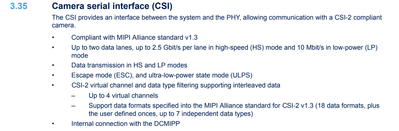

STOne-32
Dear @Will_Robertson ,
You can refer to our STM32MP25 : Arm® based dual Cortex®-A35 1.5 GHz + Cortex®-M33 MPU, AI, 3D GPU,
video encoder/decoder, TFT/DSI/LVDS, USB 3.0, PCIe
Datasheet - STM32MP251A/D STM32MP253A/D STM32MP255A/D STM32MP257A/D - Arm® based dual Cortex®-A35 1.5 GHz + Cortex®-M33 MPU, AI, 3D GPU, video encoder/decoder, TFT/DSI/LVDS, USB 3.0, PCIe®
It supports natively Camera CSI-2
Hope it helps you.
STOne-32.

Hi @Will_Robertson
Both boards listed below are suited for STM32MP2 Camera evaluation :
STM32MP257F-EV1
STM32MP257F-DK (available in some weeks)
Choice between both depend on which final application you want to evaluate before going to develop your own board/product.
EV1 is more industrial oriented (3 x Ethernet, DDR4 USB2.0, PCIe, FDCAN, DSI, CSI, LVDS)
DK is more consumer oriented (USB3.0, LPDDR4, HDMI, WLAN/BT, audio, CSI, LVDS)
You might need to purchase camera and display separately:
7" LVDS 1024x600 Display B-LVDS7-WSVGA
5MP CSI Camera + inertial motion unit + Time‑of‑Flight sensor B-CAMS-IMX
Note that STM32MP2x products are not MCUs but MPU. I.e. intended first to run Linux on Cortex-A processor and bare metal coprocessing on Cortex-M processor.
Many information also on ST MPU wiki : https://wiki.st.com/stm32mpu/wiki/Main_Page
Regards.
