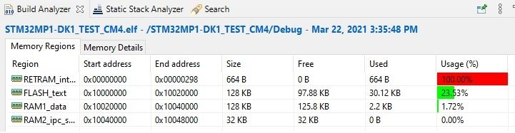

It was harder for me to understand what will be available for the M4 (where most our processing will be). I decided to build a simple project and take a look at the resources available (to make sure we have at least 256 kb of RAm to work with so we can port a good chunk of code over from the WB55. When I looked at the resources available, i was a bit confused:
0693W000008xcgoQAA.jpgI'm not sure how the above description correlates to the current settings. Is the RAM configuration customizable to I can allocate more RAM to the M4? if so, is this something that's done in the IDE or would I make the changes in the linker file?

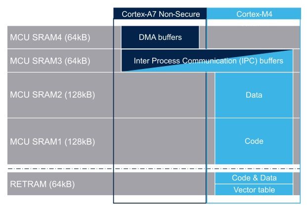

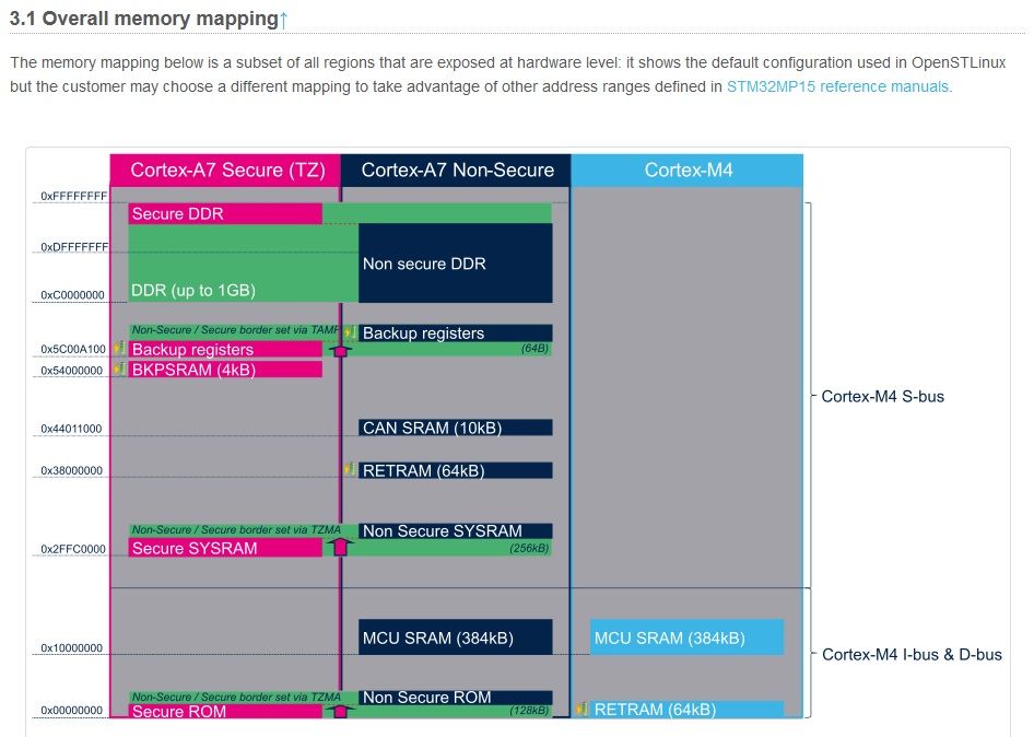

I was able to find this on that page you sent me (once again, thanks for that, great reference!)
0693W000008xchDQAQ.jpgIt does look like it should have 384 kb of SYSRAM, which I believe would be the equivalent of what I was using with the WB55. I'm looking through the IDE and the reference guide and I'm not really putting the pieces together of how it's configured or how the above settings in the IDE correlate with the diagram above. How do the above IDE settings correlate with the 384 kB of SYSRAM? Is the IDE setup with only 128 kb of SYSRAM by default (RAM1_data) and I need to change the linker files of the M4 to allocate more? Also, what is "flash_text" and "ram2_ipc_shm"?

Hi, you already find most of your information.
On OpenSTLInux, SYSRAM and DDR are reserved for A7 side,
For Cortex-M4, you have 384K+64K available for code, constant and data.
see https://wiki.st.com/stm32mpu/wiki/STM32MP15_RAM_mapping#Zoom_in_the_Cortex-A7-2FCortex-M4_shared_memory for details, as some areas could be reserved for Linux DMA buffers and Interprocess buffers.
"xx_text" is your code/constant area (mostly SRAM1/SRAM2), and "***_ipc_shm" is the interprocess buffers, see also https://wiki.st.com/stm32mpu/wiki/Linux_RPMsg_framework_overview
Regards.

Ah, I must've missed that page! Well, looks like the pieces are coming together a bit now. So, if I follow those pages, it's default setup with 128kB in SRAM2 for variables and such, and 128kB in SRAM1 for code space.
It looks like I can reconfigure it (in the linux device tree and the M4 linker file) so I can allocate the 256 kB in however I want between the two of them (so if I want 2 kB of variables and the remaining 254 kB into code space, I would set SRAM2 to 2 kB and 254kB in SRAM1), correct?
The RETRAM I'm a bit less clear on how that's configured. It appears you can move the vector start section so if you had 2 kB, you could potentially move the location to the last 2 kB, which leaves the 62 kB left for code and data? If so, how do you configure that? Similar to the way you setup SRAM1 and SRAM2.
Related question, is there a way to differentiate between data (variables) and flash (code space) in RAM or does the compiler itself know how to manage that? I'm looking at the linker code (for instance) and I see that it has the starting location and the length but I don't really see how it separates variables and code space (or if it even needs to).
