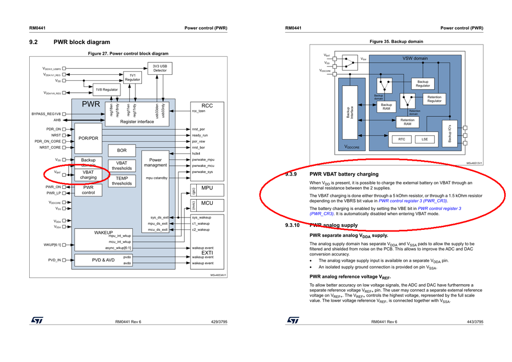

Does STM32MP15x support VBAT battery charging?
I could not find any information relates to vbat battery charging in user manual or datasheet.
Is this feature supported in STM32MP15x?
Thanks,
OlivierK
OlivierKBest answer
Apr 26, 2023 8:53 AM UTC
Hi Dat Tran (Community Member)
In OSTL (DV4.1) The optee driver enables it.
arch/arm/plat-stm32mp1/drivers/stm32mp1_pwr.c
    if (fdt_getprop(fdt, node, "st,enable-vbat-charge", NULL)) {
        uintptr_t cr3 = stm32_pwr_base() + PWR_CR3_OFF;
        io_setbits32(cr3, PWR_CR3_VBE);
        if (fdt_getprop(fdt, node, "st,vbat-charge-1K5", NULL))
            io_setbits32(cr3, PWR_CR3_VBRS);
Configurable in the DT
Add VBAT charge static configuration from the pwr regulator
device-tree node.
- st,enable-vbat-charge is used to enable charge
- st,vbat-charge-1K5 is used to enable fast charge with 1500 Ohms.
You may try to set it at optee board level in the "&pwr_regulators" node
Regards,
Olivier

waclawek.jan
Apr 25, 2023 5:49 PM UTC
_legacyfs_online_stmicro_images_0693W00000bio0bQAA.pngJW

PatrickF
Apr 26, 2023 9:20 AM UTC
Notice that this 'charge' is intended for an external SuperCap on VBAT (to avoid need for an external diode+resistor), must not be used with Lithium Coin-cell or any kind of rechargeable battery.
As written in product reference manual, the 'charge' resistor is automatically disconnected in absence of VDD.
Regards.

Thank you. Yes we are using SupperCap.
Following code above, only enable charge, do we need to stop charging? what if the cap is full?
PatrickF
Apr 26, 2023 2:27 PM UTC
no need to disable as capacitor charge current will null when its voltage is equal to VDD.
No risk of 'overcharge' a capacitor (it's not a battery).
Just need to enable charge resistor on each cold boot (as PWR_CR3 register is not saved in VBAT), but this is already the case if selected in DeviceTree as listed above.
