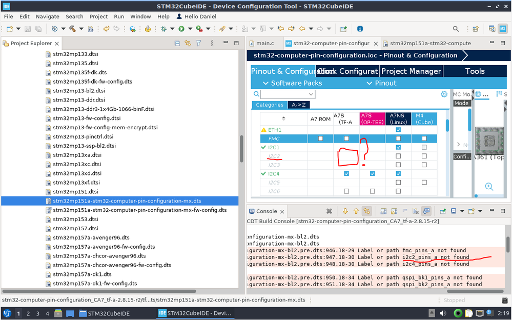

I have installed OpenSTLinux SDK + Sources (linux, tf-a, u-boot, optee-os) on a STM32CubeIDE project.
I have compiled optee-os for my custom board, but it did not work so well for tf-a.
This is clearly a bug because I cannot add "i2c2_pin_a" into the .dts file of stm32mp151-stm32-computer-pin-configuration-mx.dts. If I rename
i2c4_pins_mx -> i2c2_pins_a
manually inside the .dts file, then the error disapear when I compile. But I cannot do that in STM32CubeIDE because it does not allow me to add "i2c2" for TF-A.
So is there any walk around for this bug?

 And the .dts file is:

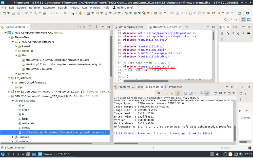

Hi!
I found the solution. You MUST add #include "stm32mp-pinctrl.dtsi" here.

Hi!
