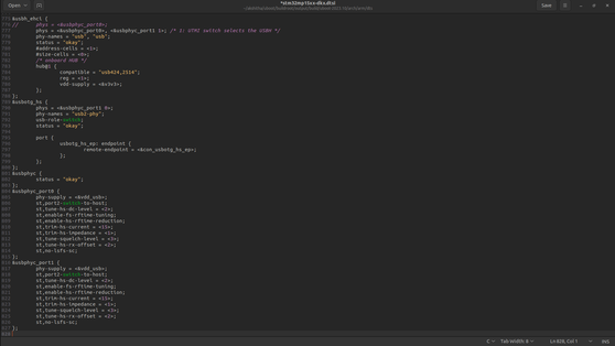

Hello
We are Working on a custom board with STM32MP157AAA3 processor.We are using Buildroot(V2023.08.2) for checking USB 2nd Port in which the PHY port 2 is configured as host controller using UTMI .
we referred the below link to configure the dts :
We are configuring the USB in dts file exactly the same in Uboot (V2023.10) and Linux(V5.13), It works in Linux but not in Uboot
We are attaching the configuration of our dts file below.Hope you could Verify it and suggest us where we are going wrong.
