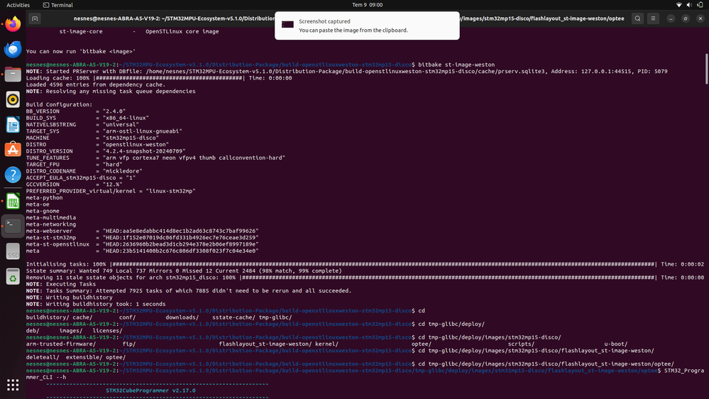

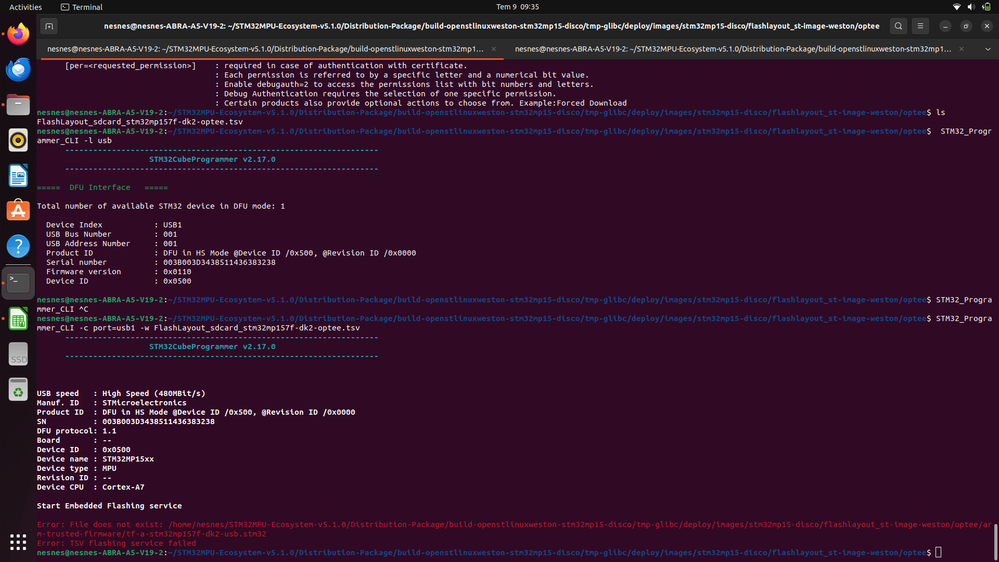

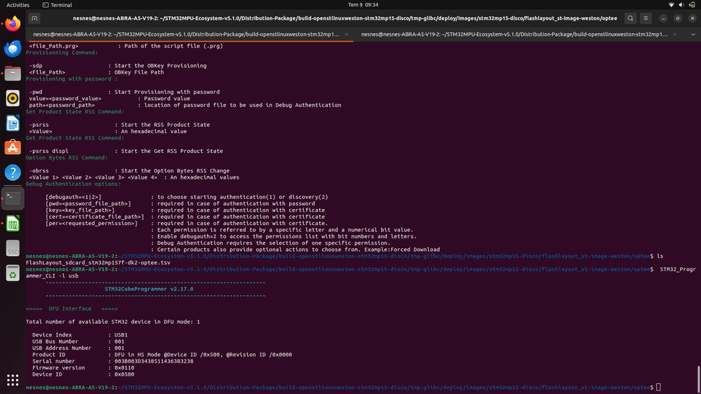

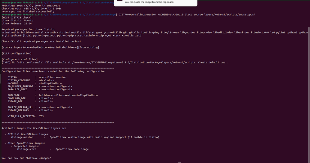

I have followed the instructions on "https://wiki.st.com/stm32mpu/index.php?title=STM32MPU_Distribution_Package&sfr=stm32mpu"

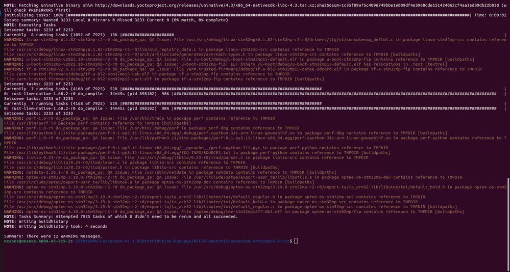

I received these warnings during the built and errors in the end. How can solve it ?
Error: File does not exist: /home/nesnes/STM32MPU-Ecosystem-v5.1.0/Distribution-Package/build-openstlinuxweston-stm32mp15-disco/tmp-glibc/deploy/images/stm32mp15-disco/flashlayout_st-image-weston/optee/arm-trusted-firmware/tf-a-stm32mp157f-dk2-usb.stm32
Error: TSV flashing service failed

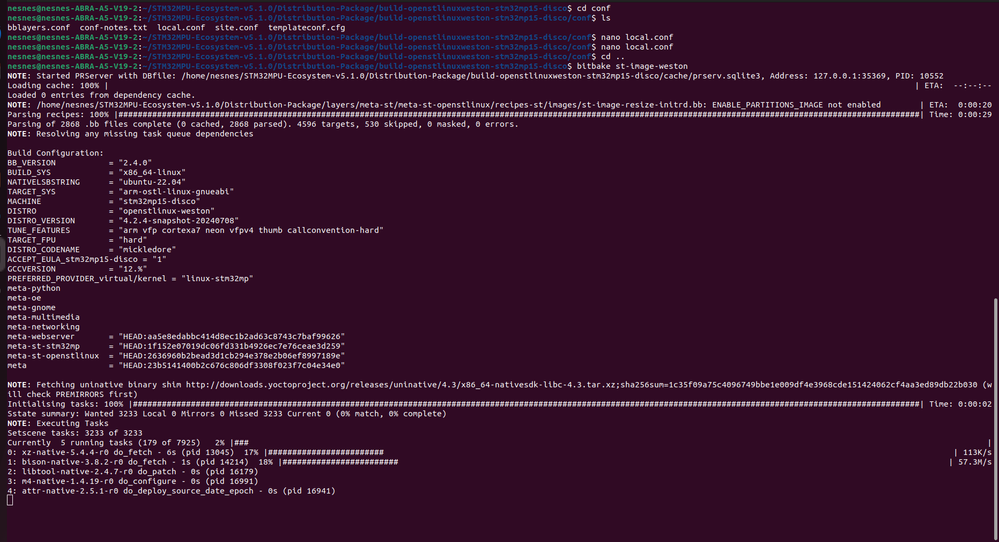

WARNING: linux-stm32mp-6.1.82-stm32mp-r2-r0 do_package_qa: QA Issue: File /usr/src/debug/linux-stm32mp/6.1.82-stm32mp-r2-r0/drivers/tty/vt/consolemap_deftbl.c in package linux-stm32mp-src contains reference to TMPDIR
File /usr/src/debug/linux-stm32mp/6.1.82-stm32mp-r2-r0/lib/oid_registry_data.c in package linux-stm32mp-src contains reference to TMPDIR
File /usr/src/debug/linux-stm32mp/6.1.82-stm32mp-r2-r0/arch/arm/include/generated/asm/mach-types.h in package linux-stm32mp-src contains reference to TMPDIR [buildpaths]
WARNING: u-boot-stm32mp-v2022.10-stm32mp-r2-r0 do_package_qa: QA Issue: File /u-boot/debug/u-boot-stm32mp15-default.elf in package u-boot-stm32mp-fip contains reference to TMPDIR [buildpaths]
WARNING: u-boot-stm32mp-v2022.10-stm32mp-r2-r0 do_package_qa: QA Issue: u-boot-stm32mp-fip: ELF binary /u-boot/debug/u-boot-stm32mp15-default.elf has relocations in .text [textrel]
WARNING: tf-a-stm32mp-v2.8.15-stm32mp-r2-r0 do_package_qa: QA Issue: File /arm-trusted-firmware/debug/tf-a-bl2-stm32mp15-optee-sdcard.elf in package tf-a-stm32mp-fip contains reference to TMPDIR
File /arm-trusted-firmware/debug/tf-a-bl2-stm32mp15-usb.elf in package tf-a-stm32mp-fip contains reference to TMPDIR
File /arm-trusted-firmware/debug/tf-a-bl2-stm32mp15-uart.elf in package tf-a-stm32mp-fip contains reference to TMPDIR [buildpaths]
