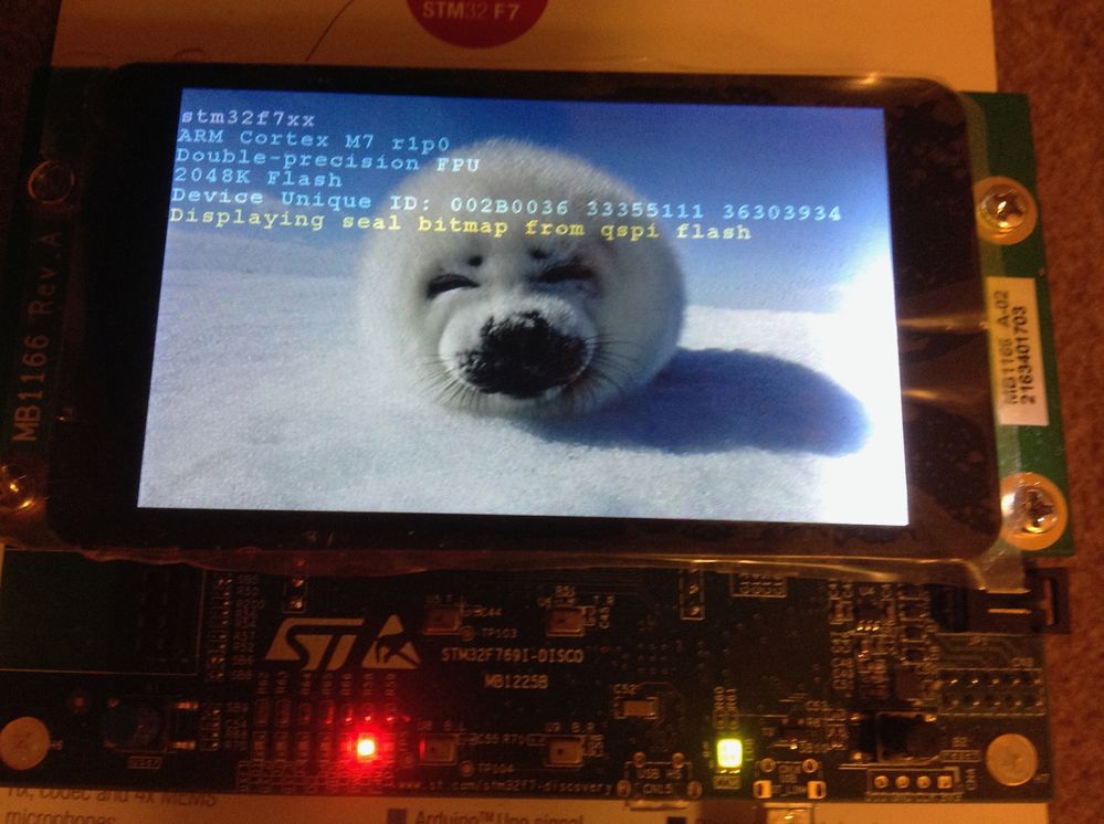

john doe
Lead
Posted on April 03, 2017 at 04:15
Thank you for posting this. I don't know anything about QSPI Flash and your code has helped me move forward. I have an STM32F769I-Discovery board and I am now able to go from micro SD card to on-board SDRAM and from there, into the Quad SPI Flash. When I try to write a second time, it screws up things, and I think it is because I am not doing an erase first.
