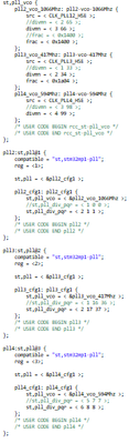

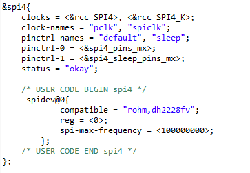

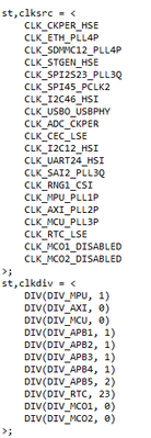

Hi, I am trying to run spidev on the stm32mp157f-dk2 using python and I have set my SPI4 max frequency above 40MHz, but I can't seem to run it more than 16MHz. I have checked the clock tree configurations and the device tree configuration; I seem to have set everything correctly but I can't seem to run it faster.

Hello Andrew! Thank you for the guidelines.
Regarding the issue, I do not get any specific error message I just cannot seem to measure the Frequency above 16MHz even though I try to run SPI4 at 40MHz or more. I'm not sure if the python documentation states any limitations and it should be able to run more than 16MHz but if I try to run at 40MHz, my code works but I cannot see the equivalent frequency of the clock when I measure it.
