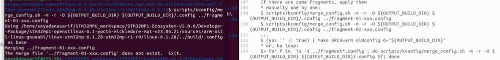

i am using ubuntu 22.04 ltsScreenshot from 2024-03-12 16-53-58.pngThe above mentioned photo  is what was the output when i follow Readfile. How to do.txt;
i cannot able to figure out what was the issue.And because of this issue i am getting this issue isn't it?  (below attached)

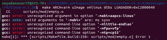

Now this error evolved like this.

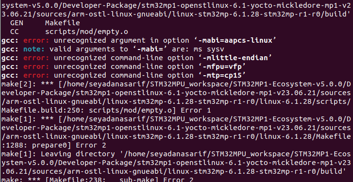

Did you source the SDK before compiling?

yes,but first i did it wrongly. now i sourced the file and build kernel on same terminal(only changed directory based on your location). now issue shorted. thank you
