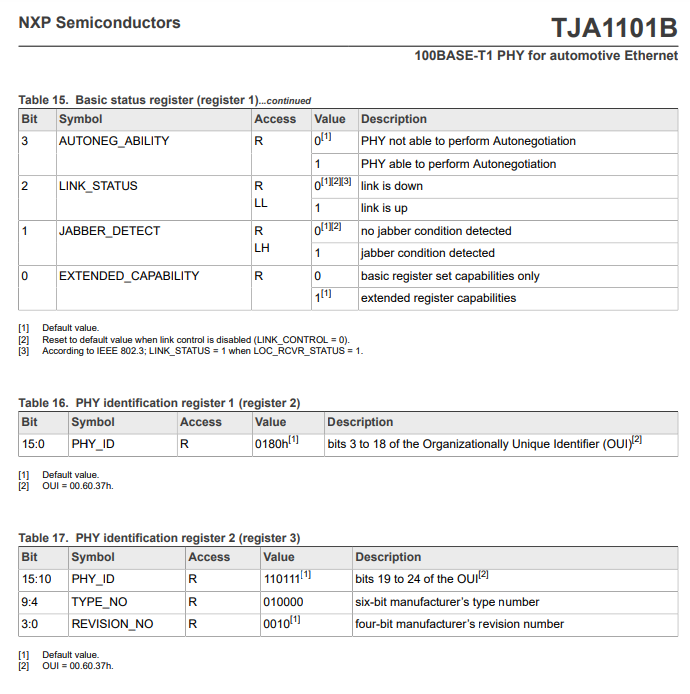

Are you sure about the ID used for your phy? In the datasheet  PHY NXP TJA1101 :
0693W00000QM4pQQAT.pngI would go for compatible = "ethernet-phy-id0180.dd02" instead ( [3:0] depending of the phy revision)

Thanks for your input Olivier. I implemented the changes but still had eth_send errors. I noticed that after the negotiation with the PHY, the speed was set in 10Mbps and halt-duplex. The TJA1101 is full duplex. Besides, the ETH_COL and ETH_CRS signals on the processor weren't connected (ETH_CRS was uses as WAKE port). So I try to force it in full-duplex by adding:
