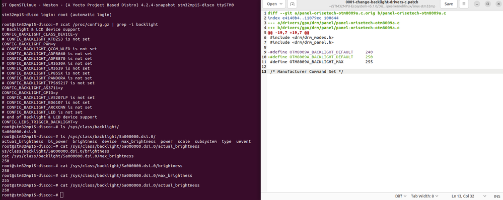

nesnesAuthor
July 16, 2024
Thank you @Erwan SZYMANSKI . I followed the same patching steps for panel-orisetech-otm8009a.c file
here my  .bbapend and patch  files in the directory of my own layer ~/STM32MPU-Ecosystem-v5.1.0/Distribution-Package/layers/meta-my-layer/recipes-kernel/linux/linux-stm32mp
nesnes@nesnes-ABRA-A5-V19-2:~/STM32MPU-Ecosystem-v5.1.0/Distribution-Package/layers/meta-my-layer$ tree
├── conf
│ └── layer.conf
├── COPYING.MIT
├── README
├── recipes-example
│ └── example
│ └── example_0.1.bb
└── recipes-kernel
 └── linux
 ├── linux-stm32mp
 │ └── 0001-change-backlight-drivers-c.patch
 └── linux-stm32mp_%.bbappend
FILESEXTRAPATHS:prepend := "${THISDIR}/linux-stm32mp:"
SRC_URI += "file://0001-change-backlight-drivers-c.patch"
diff --git a/panel-orisetech-otm8009a.c.orig b/panel-orisetech-otm8009a.c
index e4140b4..11079ec 100644
--- a/drivers/gpu/drm/panel/panel-orisetech-otm8009a.c
+++ b/drivers/gpu/drm/panel/panel-orisetech-otm8009a.c
@@ -19,7 +19,7 @@
 #include <drm/drm_modes.h>
 #include <drm/drm_panel.h>
-#define OTM8009A_BACKLIGHT_DEFAULT	240
+#define OTM8009A_BACKLIGHT_DEFAULT	100
 #define OTM8009A_BACKLIGHT_MAX		255
 /* Manufacturer Command Set */
 After creating these files I enabled build environment and write "bitbake st-image-weston". I got some warnings but they are not relevant to my changes .
nesnes@nesnes-ABRA-A5-V19-2:~/STM32MPU-Ecosystem-v5.1.0/Distribution-Package/build-openstlinuxweston-stm32mp15-disco$ bitbake st-image-weston

Now I am gonna try flash the changes to the board , thanks a lot for your help
