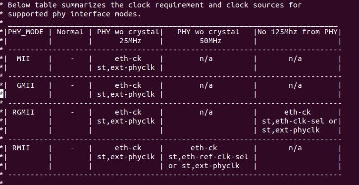

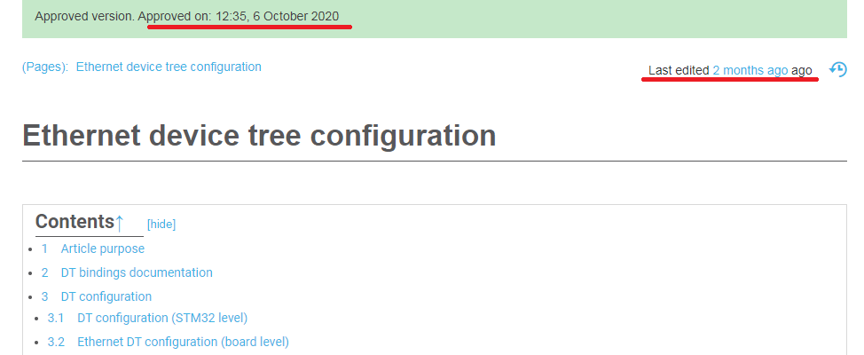

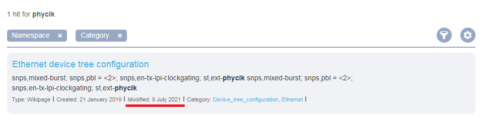

Best answer by velaros
I checked this and it seems that SYSCFG ETH_REF_CLK_SEL bit is set, so MAC is really clocked wrongly.
I digged in the linux driver (https://github.com/STMicroelectronics/linux/blob/v5.10-stm32mp/drivers/net/ethernet/stmicro/stmmac/dwmac-stm32.c) and discovered that in stm32mp1_set_mode() function it always sets this bit with enabling clock.
So using 25 MHz mode without crystal is impossible at all:
case PHY_INTERFACE_MODE_RMII:
	val = SYSCFG_PMCR_ETH_SEL_RMII;
	if ((clk_rate == ETH_CK_F_25M || clk_rate == ETH_CK_F_50M) &&
		(dwmac->eth_ref_clk_sel_reg || dwmac->ext_phyclk)) {
		dwmac->enable_eth_ck = true;
		val |= SYSCFG_PMCR_ETH_REF_CLK_SEL;
	pr_debug("SYSCFG init : PHY_INTERFACE_MODE_RMII\n");
	break;
I changed this to the following:
	if (clk_rate == ETH_CK_F_25M || clk_rate == ETH_CK_F_50M) {
		if (clk_rate == ETH_CK_F_50M &&
	break;
And now it finally works fine in 25 MHz mode, and I can see clock on PCB.
I don't really get the meaning of "st,ext-phyclk" so my patch may be wrong. But the current driver definitely seems buggy. I didn't checked U-Boot but there also may be similar bugs.
As I understand, in the master of the ST Linux repository this driver is reworked, so it may be not the issue in future releases.

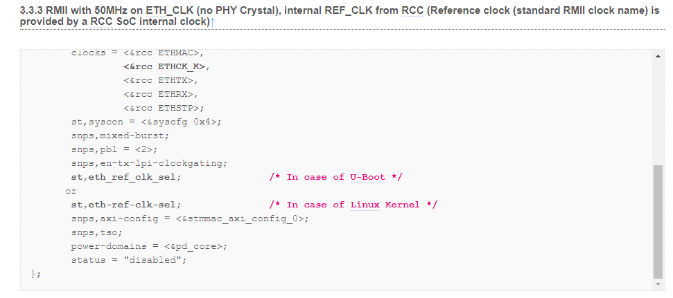

I have found that actually I don't need to use 25 MHz clock at ETH_CLK.
I changed settings to 50 MHz and patched device trees as specified at https://wiki.st.com/stm32mpu/wiki/Ethernet_device_tree_configuration#RMII_with_50MHz_on_ETH_CLK_-28no_PHY_Crystal-29-2C_internal_REF_CLK_from_RCC_-28Reference_clock_-28standard_RMII_clock_name-29_is_provided_by_a_RCC_SoC_internal_clock-29
With these setting eth0 is working right after kernel booting.
My problem is solved because it is not critical for me to use 25 MHz clock but there still may be some issue if someone really need this mode.

I wrote my device tree as said in wiki, the ethernet fragment is shown in the first message. As I can see, my settings satisfy requirements from AN5031.
To use 50MHz the config was changed as follows:
- ETH_CLK was set to 50MHz (TFA and U-Boot device trees generated from STM32CubeIDE);
- pinctrl changed, and added "st,eth-ref-clk-sel" to ethernet node:

Note that st,eth-ref-clk-sel (or st,eth_ref_clk_sel for uBoot) is for ecosystem v2.1 using kernel 5.4
For ecosystem v3 and kernel 5.10, it is st,ext-phyclk (for both kernel and uBoot).

Looking at the Ethernet driver in <linux-5.10.10>/drivers/net/ethernet/stmicro/stmmac/dwmac-stm32.c
Indeed the st,ext-phyclk seems also needed for the RMII 25MHz no crystal configuration with the ostl DV 3.0 version. Which is not what the wiki documentation says, apologies for that. Each DV version and each configuration has a specific DT configuration to respect (DV2.x, DV3.0, DV3.1)
Regarding the fact ping is still not available in 25MHz configuration, check the SYSCFG ETH_REF_CLK_SEL bit as explained by Patrick above.
I think when you use st,ext-phyclk , you select clocking of the MAC from ETH_CLK instead of REF_CLK (see SYSCFG ETH_REF_CLK_SEL bit), so the MAC is wrongly clocked with 25MHz instead of 50MHz.
	break;
	break;

Indeed you've just found a bug in the dwmac-stm32.c driver DV3.0 version. And you are right in the next versions (DV3.1 +) the "st,ext-phyclk" will be removed for the 25MHz no crystal configuration. Your patch is correct, I will report that as bug for correction on the DV3.0 version.
Thank you for this thread of messages and for your contribution in solving this issue.
