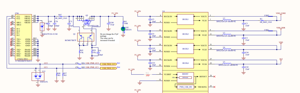

First acquaintance with STM32mp157FDK2. A couple of weeks ago I bought two sets to try. In a week I figured out how to put together my image with Yocto. And today what was supposed to happen happened. I connected the KIT to the power supply with PD3. KIT is broke. The thermal camera shows strong heating. STPMIC1APQR short circuit STPMIC1APQR. burned out. Unsuccessful test STM32mp1.

karu2003Author
April 27, 2024
his is PD3. The voltage can be up to 20V. How do ST manage CC1 and CC2?  have ST any overvoltage protection?
for ESD why didn't it work ESDA7P120-1U1M

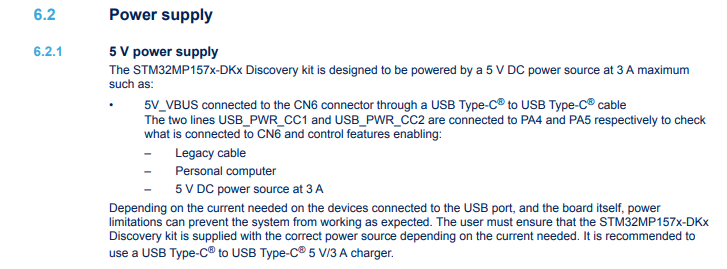

Really 20V ?

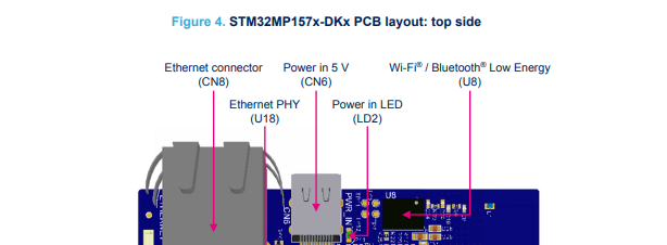

from manual UM2637 :

HI @karu2003
I'm sorry to see that you had hardware issue with your board.
The STM32MP157F-DK2 is working without issue with any USB Type-C charger which are USB certified.
As per USB-C and Power Delivery standard
  • charger should not provide any supply until CC lines are loaded
  • charger should always start with 5V supply until there is successful Power Delivery negotiation for higher voltage
The STM32MP157F-DK2 has no power delivery interface, so it is not possible to request something else than default 5V. That's the case of many USB-C powered products.
On STM32MP157F-DK2, the CC lines are only used to check that the charger pull-ups are defining 3A capability according to USB standard.
The STM32MP157F-DK2 has only ESD protection and no overvoltage protection on 5V input.
Your board could be defective, so you could ask for a replacement where you purchase it.
But I suspect the STPMIC1 burn is more related to a short circuit on its external components (usually inductors) which is quite easy with a development board (e.g. probe slip or metal stuff touching the board).
Ultimately, you could also try to replace the STPMIC1A (but need some experience in soldering and adequate tools)
Regards.
