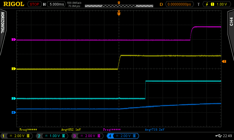

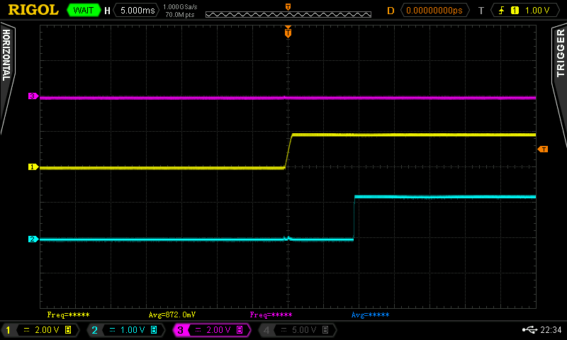

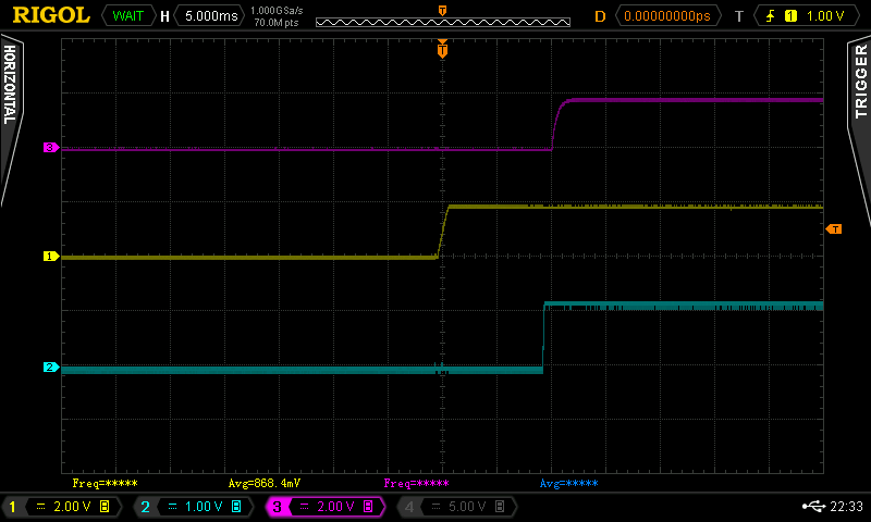

Se attached DSO images. Yellow is 1V8, blue 1V2 and magenta NRST.
Here it is when NRST_CORE is unconnected:
Now, lets connect NRST_CORE to NRST:
You can see, PWR_ON is eaxctly the same, only NRST stays low. Let's try to prove NRST_CORE forces NRST N-fet to be on.
I connected 1uF to NRST_CORE, thus delay its release by approx 20ms, blue line is NRST_CORE:
0693W000001qog5QAA.pngYou can see that NRST release is now delayed to time when NRST_CORE reaches 1.1V. One could draw conclusion that when
VDD is 1V8 (as opoosed to 3V3) NRST is held low when NRST_CORE is low.. Which would explain why interconnecting them never
boots. But it is only hypothesis yet.

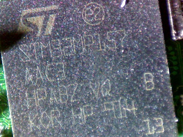

Could you please provide information of the device you use (especially revision and manufacturing date). From your schematics I see it is a TFBGA361 - 12x12 package.

I attached the chip image. Both chips are the same. Also relevant revision data:
0x5c005240: 135685e1
0x50081000: 20006500
