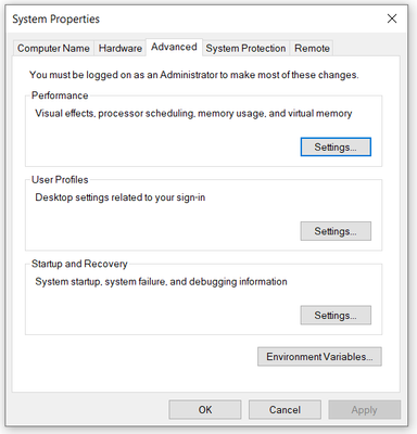

2. Proxy settings
If NanoEdge AI Studio loads infinitely on startup, check the environment variables:
  • If present, the HTTPS_PROXY variable must point to an http:// address (not https://, despite the name)
  • Try to add a new variable by clicking NEW (the bottom one). Its name should be NO_PROXY with the value 127.0.0.1
To access the environment variables, search for "environment variable" in the windows search bar and click on "environment variables".

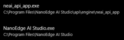

4. NanoEdge AI executables to allow
