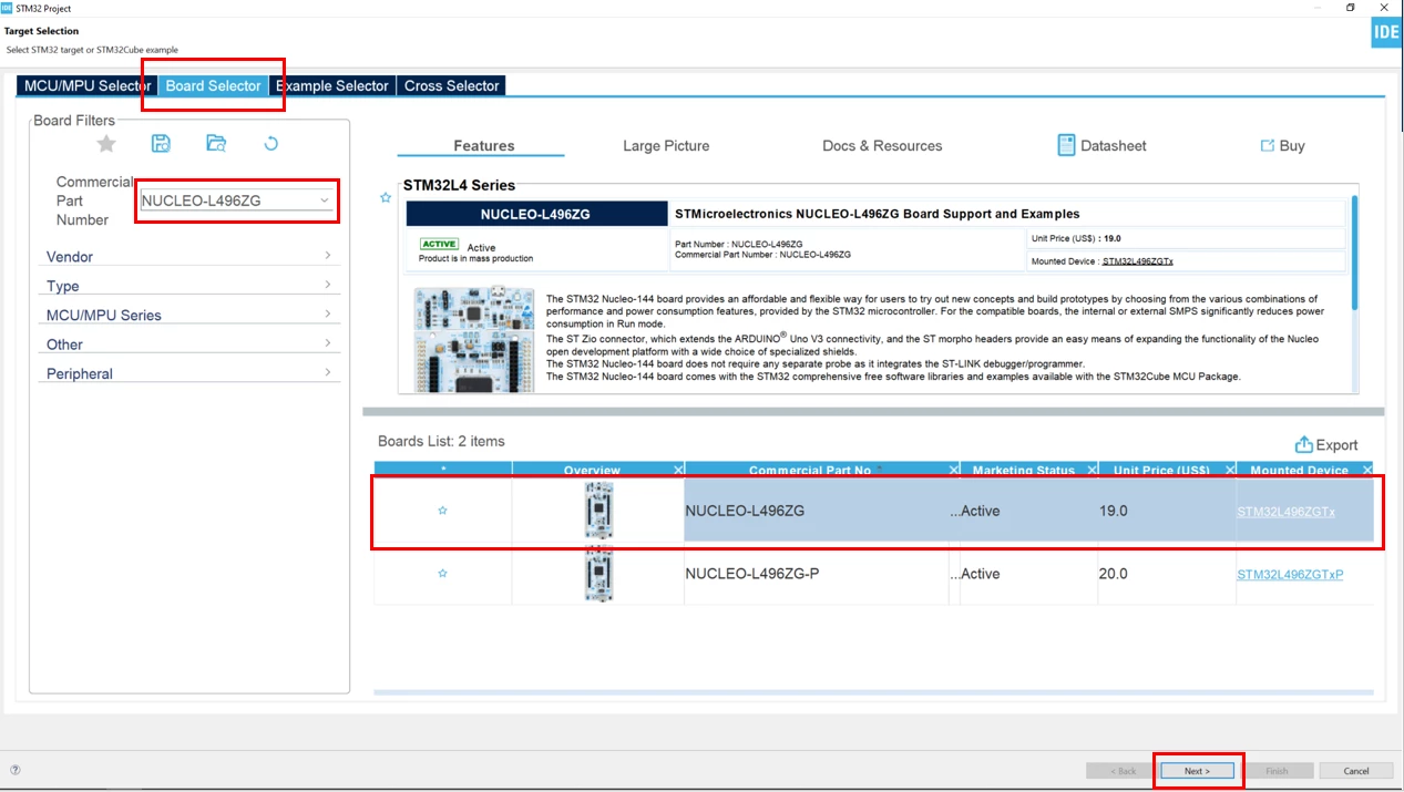

  2. Create a new project using the NUCLEO-L496ZG board

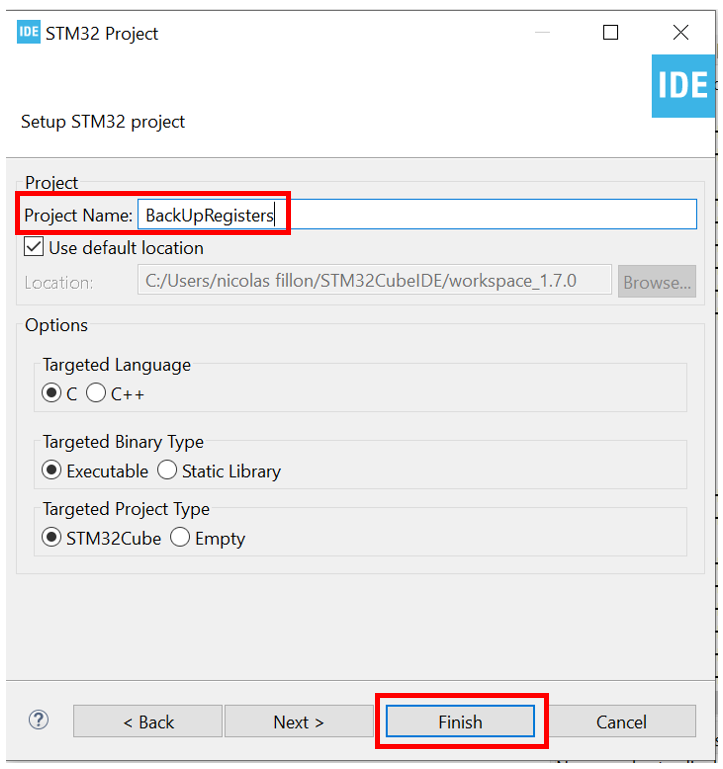

  1. Give a name to the project

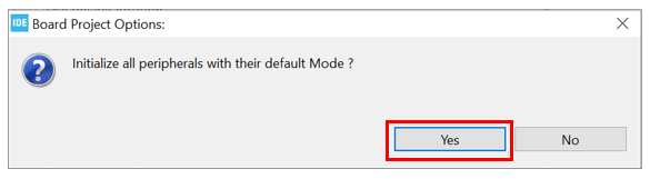

  1. Initialize all peripherals with their default settings

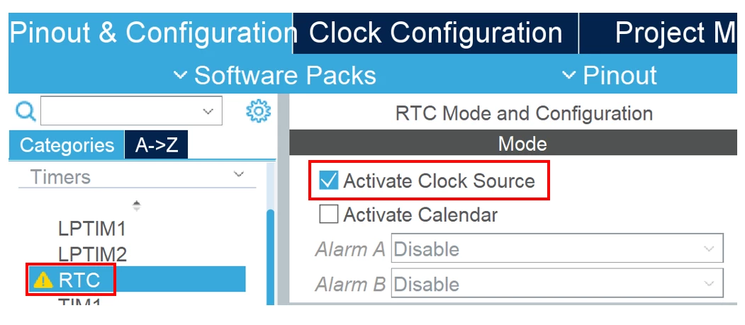

  1. Enable the RTC
The BackUp Registers are part of the RTC peripheral so we will need to enable the RTC to be able to access them. In Pinout & Configuration Tab, go to Timers, and select RTC and then in the RTC Mode and Configuration. Activate the clock source to enable the RTC.

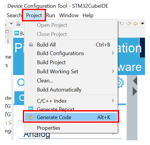

  1. Generate Code
Project -> Generate Code

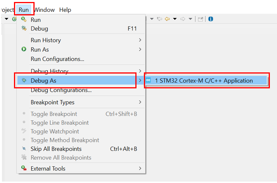

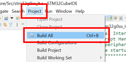

  1. Build the project, enter debug mode and run the code
After the project is built, enter a debug session in order to flash the code.

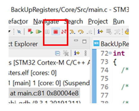

We can now terminate the debug session by clicking on the red square icon.
This will exit the debug session and then the code will be executed. You should see the blue LED2 that is turned on indicating that the check of the backup register 1 did not pass and that we then wrote a data to it.
