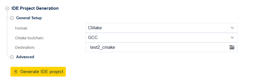

1. Generate a CMake project from STM32CubeMX2
  1. Create an STM32CubeMX2 .ioc project.
  2. In Project Manager → IDE Project (IDE Project Generation area), set:
    • Format: CMake
    • CMake toolchain: GCC
    • Destination: a folder where the CMake project should generate.
  3. Click Generate IDE project.
When generation completes, verify that the destination folder contains:
  • CMakeLists.txt
  • Core/, Drivers/, and other generated folders.
  • The .ioc file.
Figure 1. IDE project generationFigure 1. IDE project generation

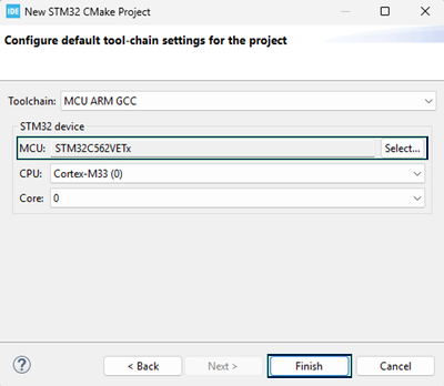

4. Configure the toolchain and MCU
The wizard opens the "Configure default tool‑chain settings for the project" page.
  1. Configure:
    • Toolchain: MCU ARM GCC (or matching your setup).
    • MCU: Select the same device as in the STM32CubeMX2 project.
    • Example used: STM32C562VETx.
  2. Click Finish.
Figure 5. Configure the toolchain and MCUFigure 5. Configure the toolchain and MCU

Apr 17, 2026 9:32 AM UTC
Minor typo in section 4. The image show STM32C562VETx and the description says "Example used: STM32C562RETx"
Laurids_PETERSEN
ST Community Manager
Apr 20, 2026 11:32 AM UTC
Thanks for catching that @Tom_pm. I have updated the article accordingly.
