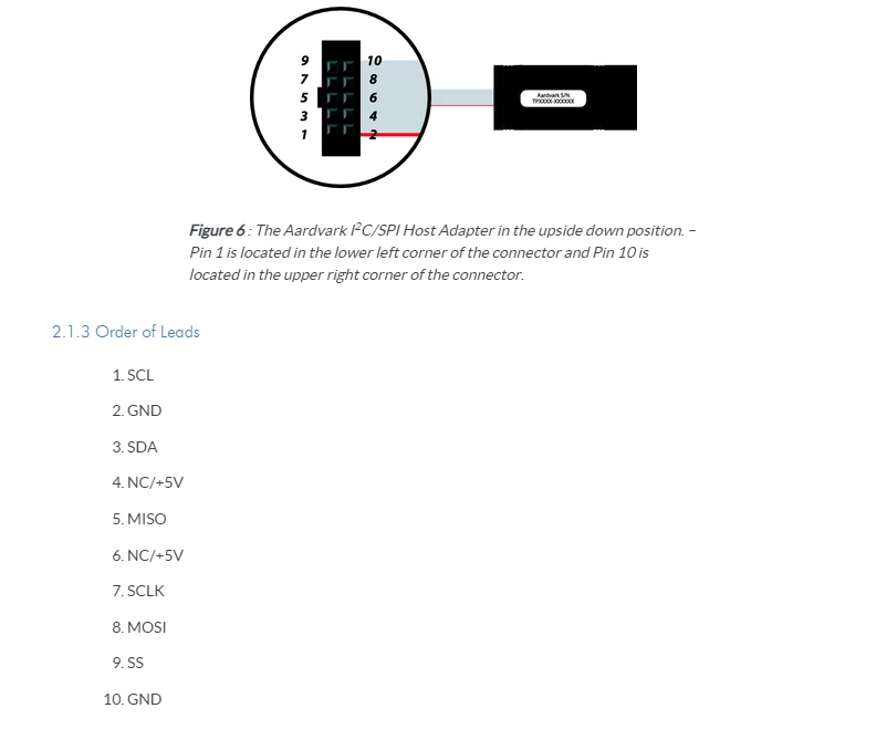

The pinout of the Aardvark:

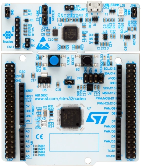

Nucleo-G070RB:

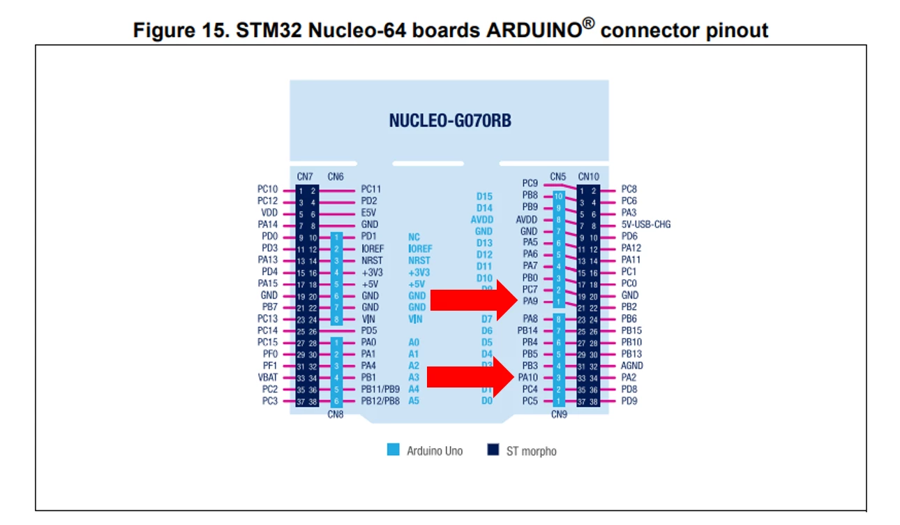

  • PA9 and PA10 of the STM32G070 on the Nucleo-G070RB will be used for the I2C communication.
Connections:
  • NUCLEO-G070RB Set-up:
    • Connect the SCL  line of Master Aardvark to I2C_SDA line of the Nucleo target Board (PA9: pin 21 of CN10).
    • Connect the SDA line of Master Aardvark to I2C_SDA line of the Nucleo target Board (PA10: pin 33 of CN10).
    • Connect GND of Aardvark board to GND of Nucleo Board.
The software Control Center from Total Phase will be used to setup and control the master I2C communications with the STM32 I2C target code.

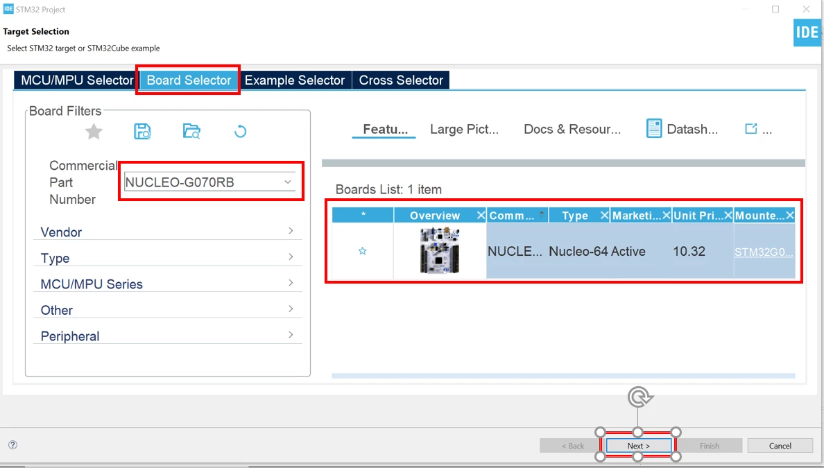

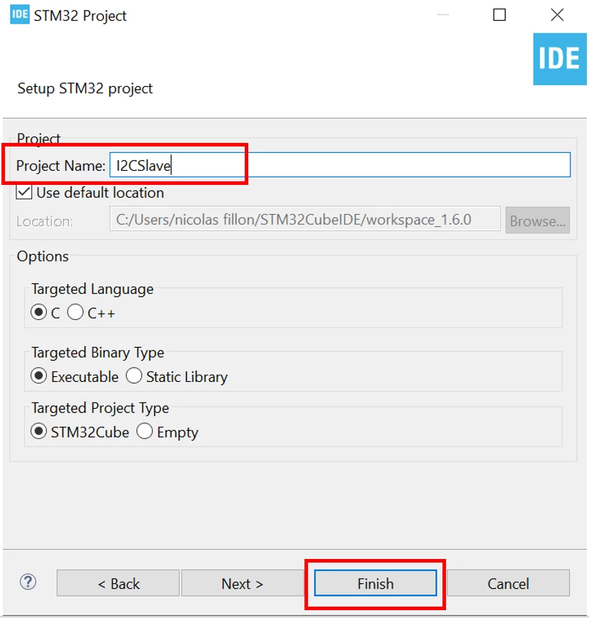

  1. Open STM32CubeIDE
  2. Create a new project using the NUCLEO-G070RB board
  1. Enter a name for the project (in this case, the project is named I2CSlave).

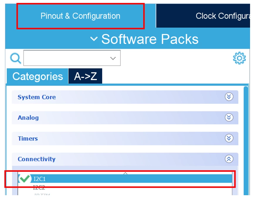

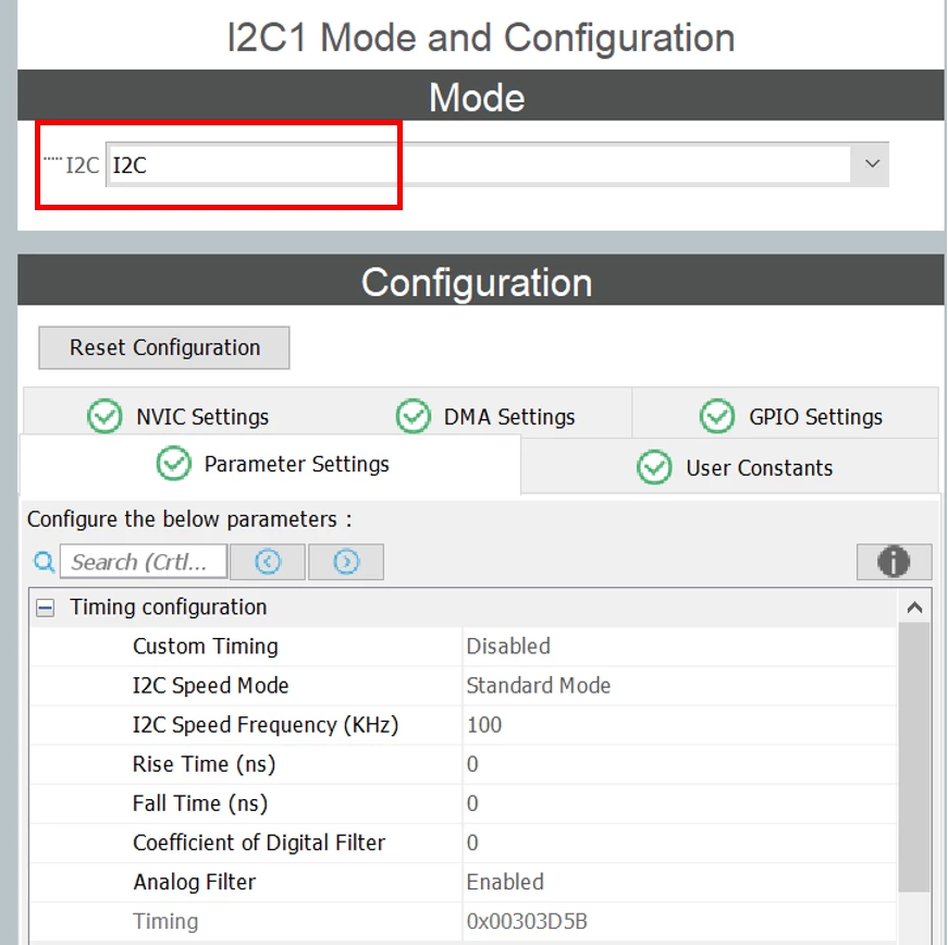

  1. Select the I2C peripheral
  • In Pinout & Configuration Tab, under Communication, click on I2C1 peripheral.
  1. Enable I2C mode and keep the default Timing Configuration

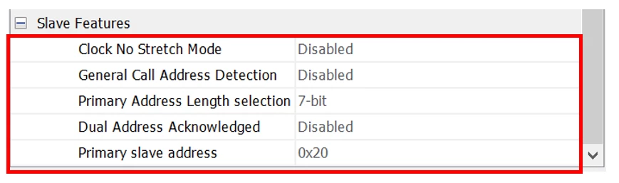

  1. Configure the target part by adding the I2C slave address
  • For this example, 0x20 will be used as the I2C slave address. The rest of the default configuration is kept.

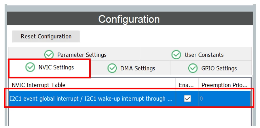

  1. Enable I2C1 interrupts
  • As mentioned earlier, the I2C communications will be handled using Interrupts which is the most convenient and efficient way to handle target communication.
  • In NVIC tab enable the Interrupts as shown below:

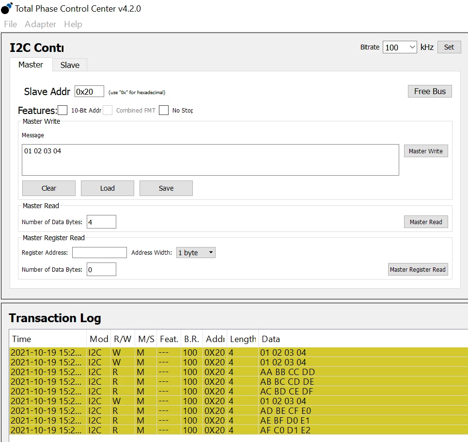

In the Total Phase Control Center software, connect to the Aardvark device. The Aardvark is configured to act as an I2C Master. We are testing our code for I2C target transmit and receive by sending some I2C Master Reads and Writes as follows:
  • Send a buffer of 4 bytes “01 02 03 04” two times (Master Write).
  • Master read of 4 bytes three times (Master Read).
As shown in the Transaction Log, the STM32G0 I2C target code received and transmitted data as expected.
