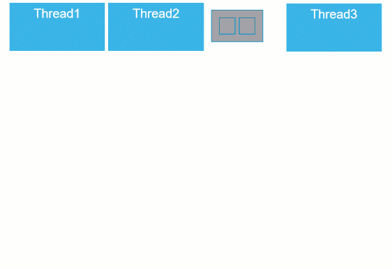

This article will show you how to start a project from scratch, with the goal of getting 3 Threads with same priorities to showcase the usage of a counting semaphore to only print a given message upon receiving the semaphore token twice. In this demo, the Thread3 will wait until Thread1 and Thread2 uses the tx_semaphore_put function to synchronize the printf message
Demo block diagram is shown here in the following animation:

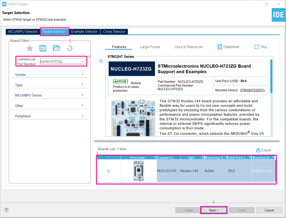

In the information Center, select to Start New STM32 Project

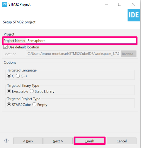

For this demo, we’ll use the NUCLEO-H723ZG as the starting point:
Give your project a name, just remember to avoid space and special characters – if you are missing any libraries, the STM32CubeIDE will automatically start the download now

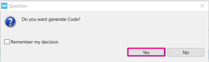

A pop up asking if we should initialize the peripherals in the default mode, click "Yes". Then second popup to ask to open device configuration perspective, click "Yes" again

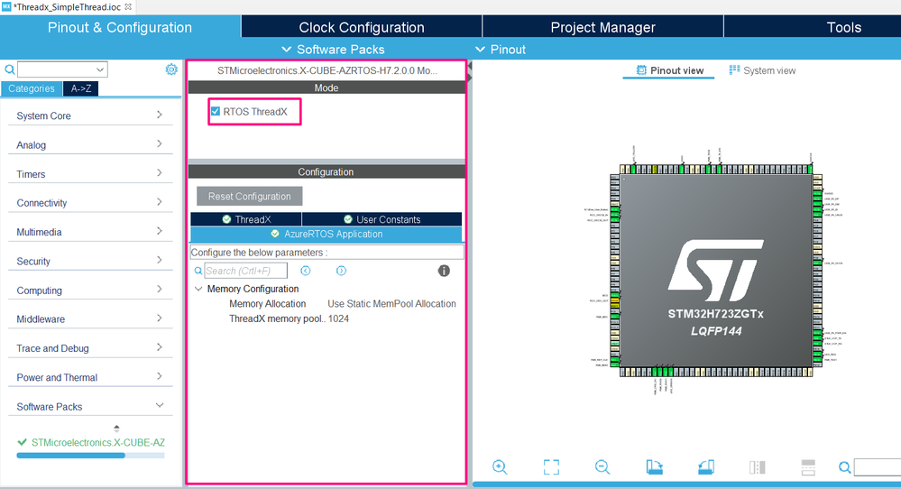

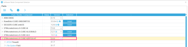

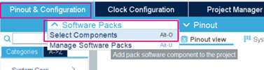

Time to add the software pack:

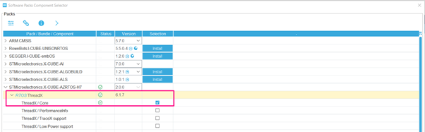

Browse and locate the AzureRTOS pack in the component selection window:
Open the RTOS ThreadX and check the Core box and click OK
This will add the Software Pack in the lower part of the Categories. Now, by clicking on it, you can add the RTOS ThreadX box, this will show the configuration options for the AzureRTOS application

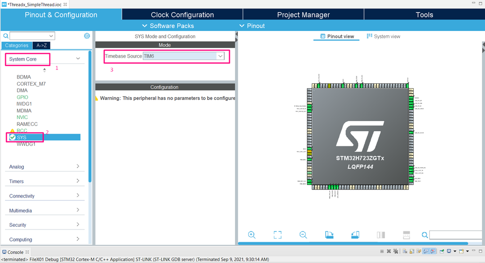

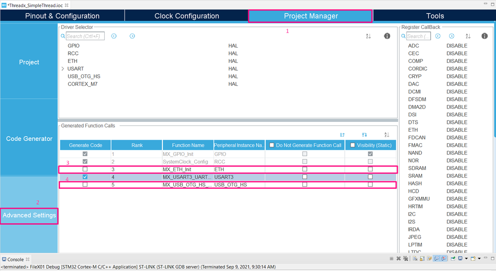

As this demo is just meant to create small prints to indicate which thread it is, the default settings are alright, but we do need to do one other modification. By default, the HAL driver will use the Systick as its primary time base, but this timer should be left to the AzureRTOS only. To prevent this conflict, we can simply select a different time base for the HAL by clicking in the System Core/SYS and selecting the time base Source as TIM6:
One final modification, to prevent generating too much unused code, we can decide to not create the functions for USB and Ethernet, as they were natively added when we created the design based on the board, this can be done by removing the Generate Code for them:
All set, we can press Alt+K to generate the code and Ctrl+S to save it:

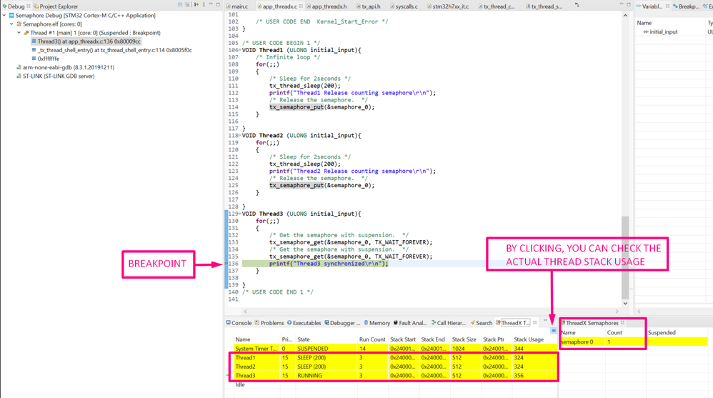

The last part is to create our demo code. Open Core\Src \app_threadx.c – Here we’ll create the 3 threads using the command tx_thread_create and the semaphore, by using tx_semaphore_create.
All 3 threads are quite simple, where Thread1 and Thread2 are sleeping for 2 seconds and then using the tx_semaphore_put in an endless loop. The Thread3 will use the tx_semaphore_get twice in a row, to wait for both threads to share their semaphore token before it can use the printf. You can copy and paste the code below - Please use the "USER CODE BEGIN" as a reference to paste in the generated code:

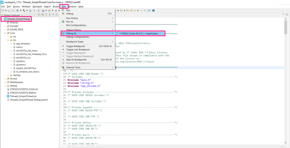

From this point, press Ctrl+B to build and you should see 0 errors and 0 warnings.

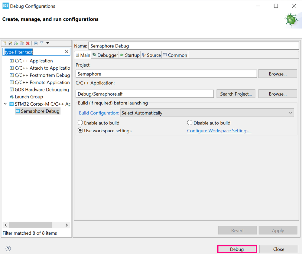

Connect the board to the computer and enter in debug mode by first clicking in the project name, then menu Run/Debug As/STM32:
In Edit Configuration window, click Debug:
Once in the Debug perspective, click on the resume to enjoy your ThreadX application with semapahore working. You can also use the Window/Show View/ThreadX/ThreadX Thread List and do it again for the ThreadX Semaphores to enhance the overall debugging options (the thread list will be automatically loaded once the application runs for a bit and is paused):

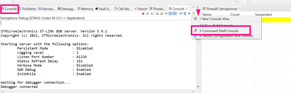

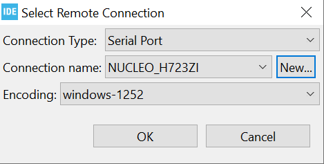

Now, the last step is to enable the console inside the STM32CubeIDE to see the print messages. Locate the Console tab and click Command Shell Console:

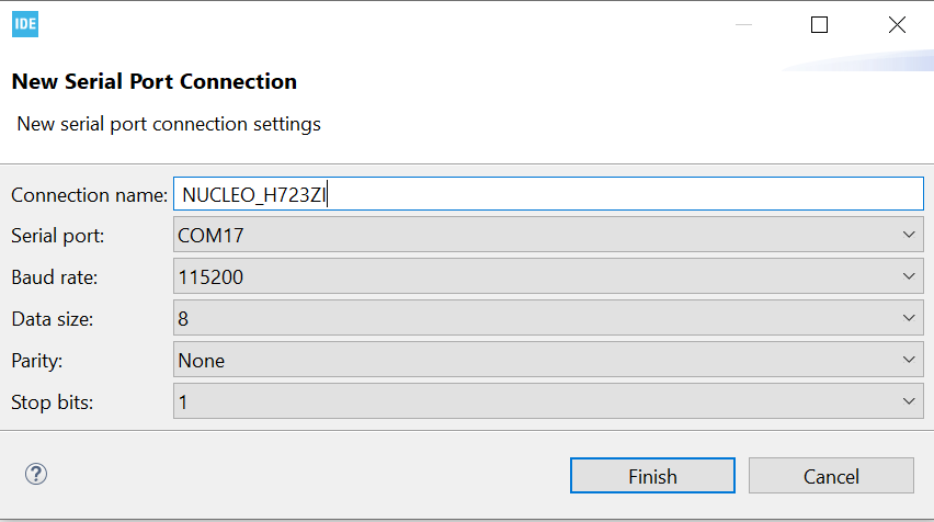

In the pop-up window, change the Connection Type to Serial Port and click on New… to add the VCOM related to your STLINK:
You can give the port a name, so it is easier for later usage as well, in this case, it will be labelled as NUCLEO_H723ZI:
By clicking finish, the message on the console will indicate it is now connected, by resuming the application, this is the print display:
