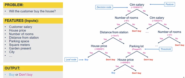

3. What is a decision tree
A decision tree is a binary tree structure made of nodes and leaves (the nodes that do not have children). A decision node has two branches or children. The leaf node represents the classification output or the decision. At each decision node, a split on the data is performed based on the threshold of one of the input features. Usually, a value less than the threshold would select the left branch, otherwise the right branch is chosen. While traversing through the decision nodes, more and more splits on the data are made, and this process stops when a leaf is reached and the decision is made. Each leaf is associated with a class label and the paths from the root to leaf represent the classification rules.
The picture below shows an example of decision tree algorithm applied to the real estate business.

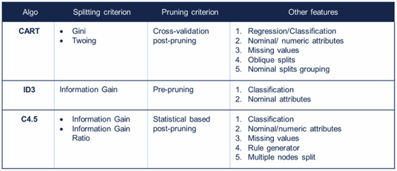

There are different algorithms to generate decision tree classifiers. The conceptual difference between these algorithms is not only in the way the splitting at each node is performed but it also differs in terms of pruning criteria and stopping criteria. The basic steps needed for the generation of a decision tree are:
  1. Splitting (node): splitting criteria such as Gini, Information Gain, or Entropy allow to maximize the information (maximizing classes separation) using one of the defined features. The process involves selecting the best feature and the corresponding threshold.
  2. Pruning: the process of decision tree pruning involves removing certain nodes in the final decision tree to reduce the size and avoid overfitting.
  3. Stopping criteria: decision trees can grow in depth to achieve 100% accuracy, but it leads to overfitting problem. All algorithms use different criteria to stop the further splitting of nodes. The criteria can be a minimum number of samples in each node or minimum gain for further splitting.
Each decision tree training algorithm has certain advantages, but C4.5 is one of the most recent algorithms , it is robust against outliers in datasets and generates a balanced decision tree.

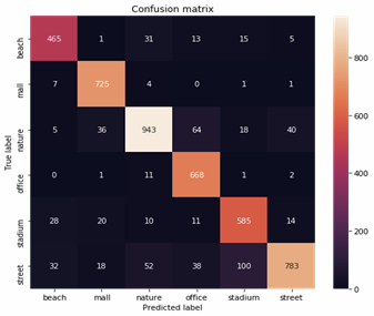

A confusion matrix can be used to summarize and display the classification performance of a decision tree. This matrix provides an overview of correct classifications and confusion between multiple classes. Since there can be different definitions to express the accuracy of a classification algorithm, the approach to use a confusion matrix is the most straightforward way to avoid misunderstanding about “accuracy”. The following figure shows an example of confusion matrix.
Confusion matrix for audio spatial environment classification
In the example above, the rows are the true classes and the columns are the predicted classes. Each cell contains the number of instances of the class corresponding to the row predicted by the model as the class corresponding to the column. This generates a mapping of the classifier between the ground truth and the prediction results. Here, we can see that the algorithm is confused between the “street” class and “stadium” class. The fifth cell of the last row in the confusion matrix shows that the algorithm incorrectly predicted 100 samples of the “street” class as the “stadium” class. The following Python code allows to build the confusion matrix as in the figure above.
