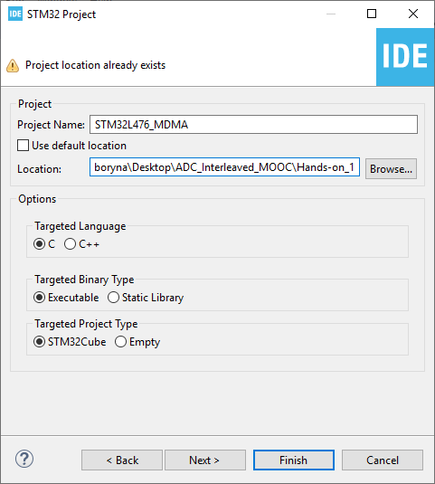

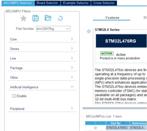

1. New project creation
  • Open STM32CubeIDE
  • File → New STM32 project → select STM32L476RG
  • Enter project name and location
  • Press Finish button

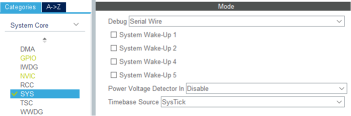

2. System Core
File → New STM32 project → STM32L476RG (NUCLEO)
Pinout & Configuration tab → System Core → SYS
Select Debug interface: Serial Wire

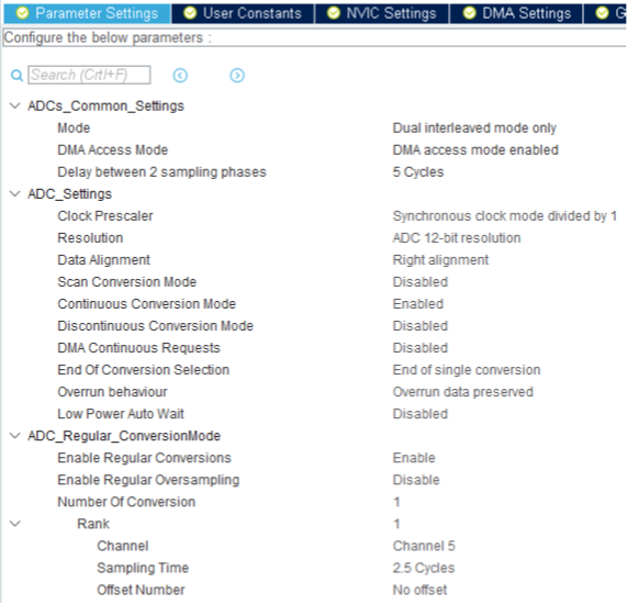

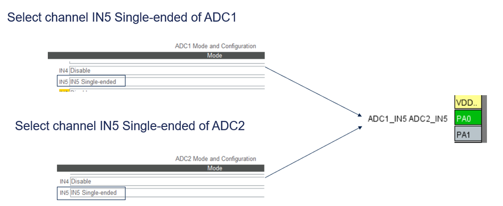

3. Analog Settings

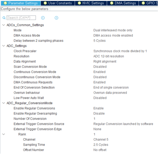

  • Pinout & Configuration tab → Analog → ADC1
  • Pinout & Configuration tab → Analog → ADC1 : ADC1 Parameters Settings tab:
    -Mode: Dual interleaved mode only
    -DMA Access Mode: DMA access mode enabled
    -Delay between 2 sampling phases: 3 Cycles
    -Synchronous clock mode divided by 1
    -Continuous Conversion Mode: Enabled
    -DMA Continuous Requests: Enabled
    -Rank 1; Channel: Channel 5, Sampling Time: 6.5 Cycles

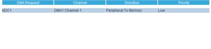

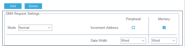

  • Pinout & Configuration tab → Analog → ADC1: Configure ADC1 in DMA Settings tab
- ADC1, DMA1 Channel 1, Peripheral To Memory, Low
- Mode: Normal,
- Increment Address: Memory,
- Data Width: Word
  • Pinout & Configuration tab → Analog → ADC2 : Configure ADC2 in Parameters Settings tab

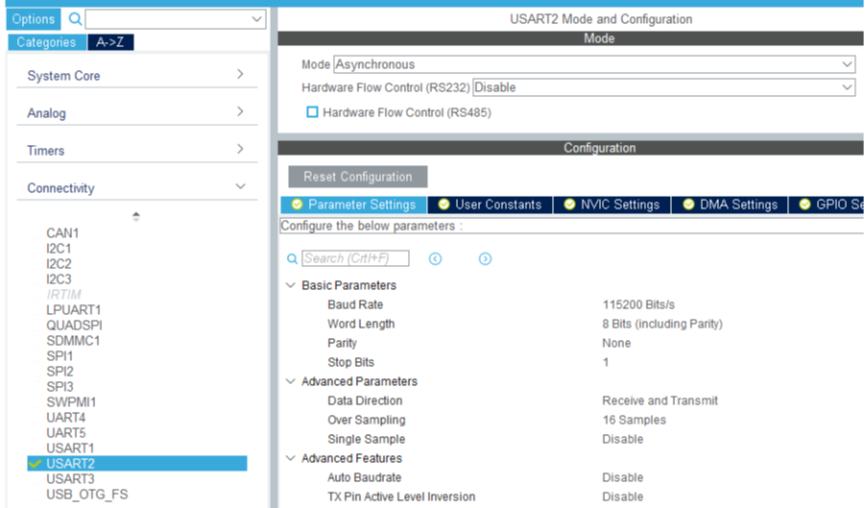

  • Pinout & Configuration tab → Connectivity → USART2
USART2 Mode: Asynchronous
USART2 in Parameters Settings tab
-Baud Rate: 115200 Bits/s,
-Char Length: 8Bits,
-Parity: None,
-Stop Bits: 1

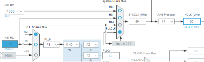

4. Clock Configuration tab
  • Set HCLK frequency as 80MHz

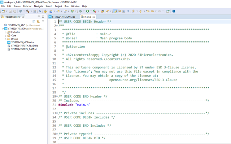

5. Generate code
  • Open C perspective and edit main.c file
6. Insert relevant code in main.c
  • Follow user code section names, section by section and put relevant code of main.c

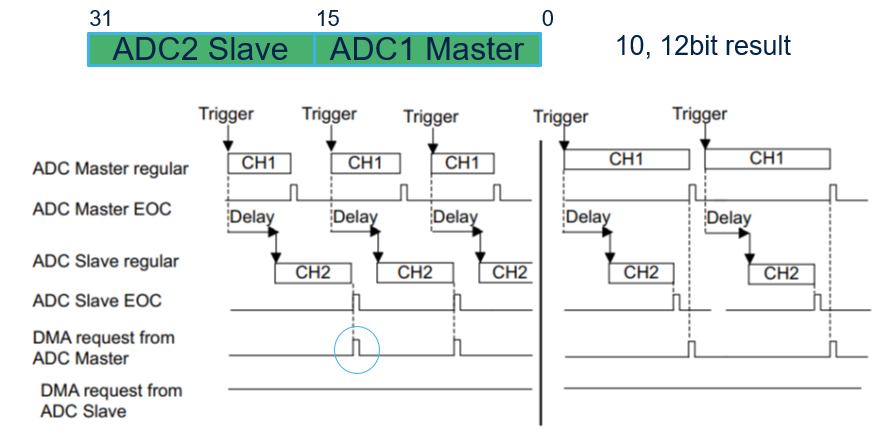

7. MDMA mode
  • MDMA=0b10: a single DMA request is generated each time both master and slave EOC events have occurred, 32-bit register ADCx_CDR contains the two half-words representing two ADC-converted data items (10 or 12 bit).

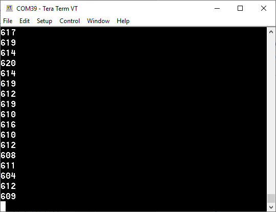

  • 10. Start terminal: 115200,8,N,1 and observe ADC results, check if application is running

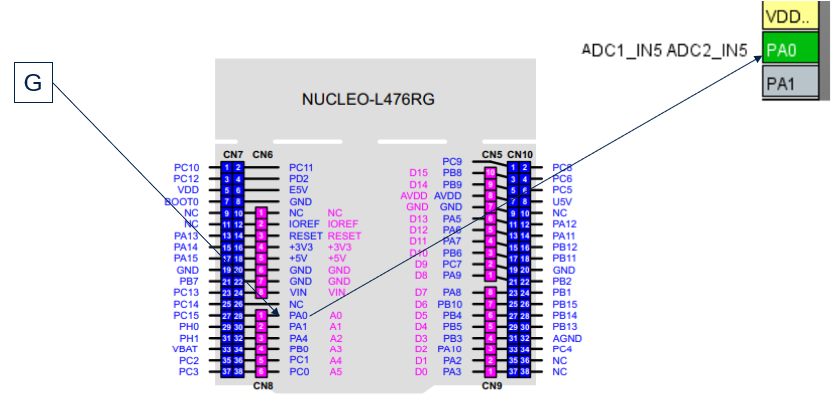

  • 11. Connect signal generator: sinus 500kHz / 3Vpp, follow MCU electrical limits (unipolar voltage), pin 1 of CN8 or pin 28 of CN7
