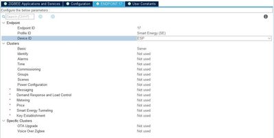

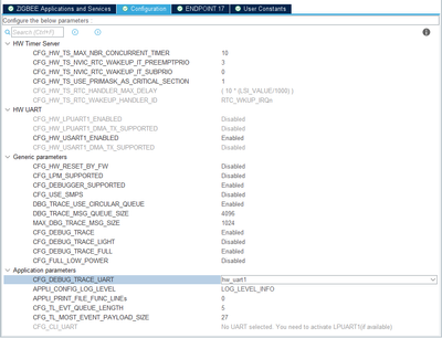

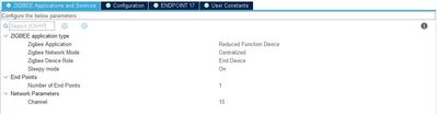

2- I uploaded the M0 binary stm32wb5x_Zigbee_RFD_fw.bin, enabled sleepy mode and and to enabled the flag CFG_LPM_SUPPORTED. Unfortunately also the logging does not work. This is my current configuration:
Best regards
August 12, 2024
The debug trace feature is disabled by default with the flag ( CFG_DBG_TRACE )  for applications that needs to activate the full low power mode, you may enable it manually on your code => CFG_DBG_TRACE with the desired level ( only for debug).

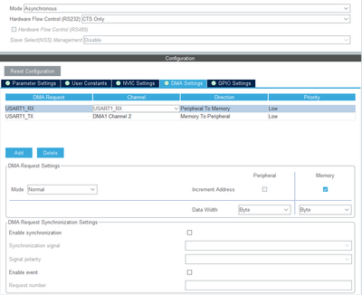

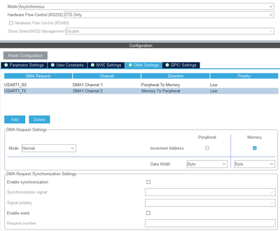

Could you please share your UART configuration and DMA settings ?
You need to make sure that DMA is activated as the DbgOutputTraces function uses the DMA to transmit data.
Regards,
Ouadi
NameAuthor
August 12, 2024
I followed the instructions given in the configuration interface.
Best regards
August 12, 2024
Looking at your settings you have to disable the Hardware flow control RTS/CTS which is only used for RS232 communication.
Best regards,
Ouadi

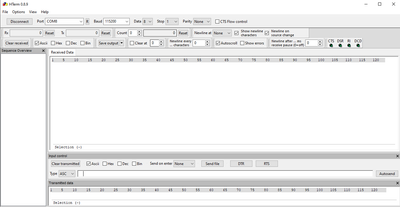

I found a possibility to read the serial output from the micromod development board.
I started with a fresh project to eliminate possible errors or incompatibilities from the old project.

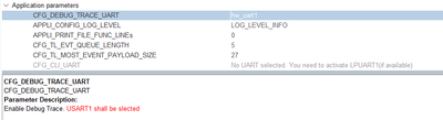

First, I set up only the standard USART1 output on STM32WB5MMGHx PA9 and PA10. Serial output works as expected in this simple setup.

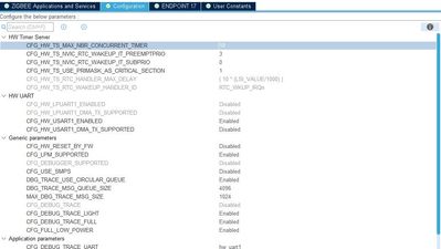

Now, I want to continue as simple as possible to get the debug traces to work when running Zigbee. For this, I set up the device to work as coordinator/reduced function device, with all settings left to standard (no sleep mode), except the ones to get the debug traces to work. The projects builds without errors or warnings. Result: no output at all, despite the serial working before.
I appended my configuration here:
I appreciate any help!
Best reagards
NameAuthor
September 9, 2024
Hello Ouadi,
I tried changing Advanced Settings in Project Manager without success. What could be the issue of traces not being working here?
Thanks and best regards
