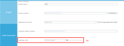

Why is the "Toolchain/IDE" configuration disabled in the "Project Manager" tab in my project?
  • December 31, 2024
  • 2901 views

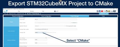

I'm following the video about using the VSCode Extension and how to convert an existing project from STM32CubeIDE to VSCode-compatible. The video says to select CMake in the Toolchain/IDE configuration in the project
But this configuration is disabled and I can't change it I don't know why
Does anyone know what's going on? What am I missing?
By the way, this is not a sample project. I created it from scratch with the CubeIDE project creation wizard.
OS: Ubuntu 22.04
STM32CubeIDE: 1.17.0
Device: STM32WB5MM
Firmware Package: STM32Cube FW_WB V1.21.0
Best answer by STTwo-32
Hello @m4l490n
This is happening because you are using the STM32CubeMX version integrated on the STM32CubeIDE. So, project will be generated for CubeIDE only. But to have a Cmake file you should use the STM32CubeMX standalone version available on https://www.st.com/en/development-tools/stm32cubemx.html
Best Regards.
STTwo-32

m4l490n
m4l490nAuthor
January 1, 2025
@STTwo-32Thanks! that was it. The standalone CubeMX works.
