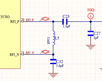

What is the impedance of STM32WLE RPI differential pair?
Levan
Do I need to set the net impedances of differential pair from RFI_P and RFI_N to 50ohm?
1 REPLY 1
STTwo-32
Hello @Levan
As you can see on the Figure 8 of the AN5407, We need to have a 100ohms of differential.
Best Regards.
