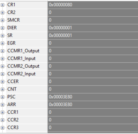

You're probably just not running the code you think you're running. There's unlikely to be a major fault in the hardware where the prescaler/auto-reload registers are ignored.
Examine the register values while running to ensure they're updated and behaving correctly.
Note that 999,999 is not a 16-bit value so isn't going to work for 16-bit registers.

You can adjust the prescaler, reload counter and clock divider. You could also set the interval to smaller than you want and have a counter variable which increments and only takes action when appropriate. There are also 32-bit timers (TIM2) which accept a 32-bit ARR value (but still only a 16-bit PSC). You could also set the system clock to 4MHz if that's what you really want. Lots of solutions here.
Edit:
If you want a timer to update at 0.2 Hz, this is possible even at max clock speed and without using the clock divider:
32MHz / 65536 / 65536 = 0.00745 Hz

And here's the screen cap of my registers, obviously not right...
I put the breakpoint after all the initialization were done. What went wrong? Some of the registers have the right value, most don't.
