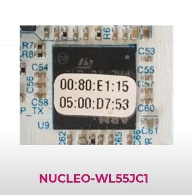

The things network does not recognize the DevEUI of the NUCLEO-WL55JC1
Salvatore5

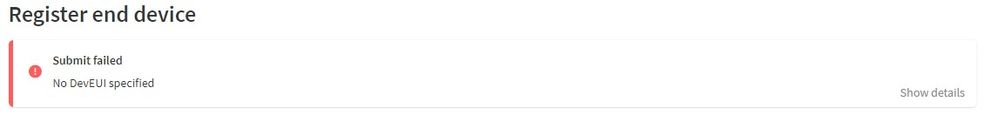

I tried to register an end-node on TTN, but it does not recognize the DevEUI.
I watched this video:
https://www.youtube.com/watch?v=8KNfrWoa1fw&list=PLnMKNibPkDnHZyJtMRpWSs41CWhPouRwq&index=3
I have entered the DevEUI here: (I copied the id that is on the board, tried several times but nothing)

Hello @Salvatore5 and welcome to ST Community
I suggest you to read the DevEUI address which is  defined from UID64 register and than use it to register your end-node on TTN. Also, make sure to follow all steps indicated in the video.
I hope this is helpful for you.
