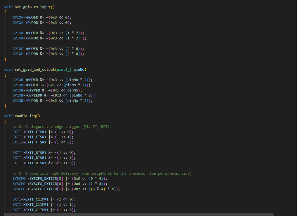

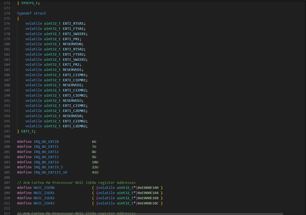

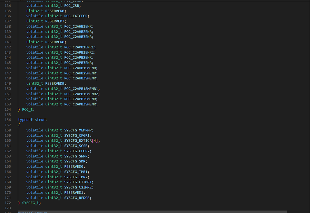

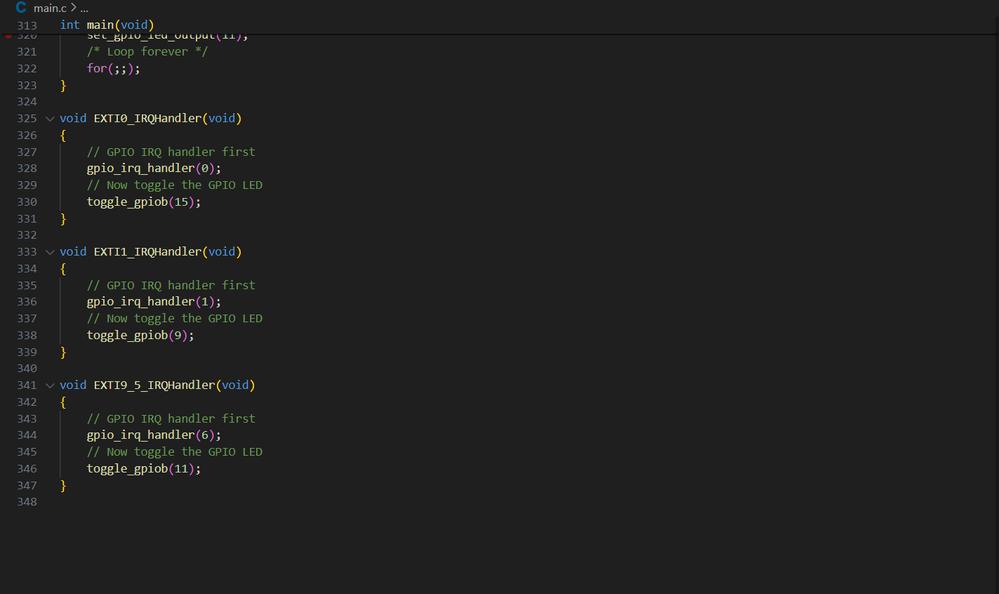

I am having an issue with configuring the C1IMR1 register, I created test code for enabling interrupts on the user buttons on the stm32wl55cj1 board but the C1IMR1 register is not being set. Below I will attach the code.

Hello @CharlieBoy242
I've tested on my side, and it works fine. Can you please send your code and give more details about this behavior?
Best Regards.
