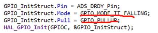

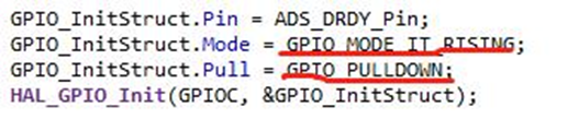

STM32WB55RGV6 GPIO pin configuration ADS_DRDY_Pin is PC11. When I change GPIO_MODE_IT_RISING to GPIO _MODE_IT_FALLING, my ble server can not work normally. Rising is ok, but I can't find my ble device(in falling).

Also, why have you changed the pull-down to pull-up?
Jaroslav
Thank you. :beaming_face_with_smiling_eyes:
It's no pull, the picture is wrong.
When I use raising edge external interruption, all is well.
When I use falling edge external interruption, the led can toggle, but I can't find my BLE device (BLE can't work). Can I think the cause of my problem is on the bluetooth side?

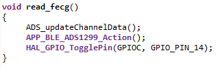

③​ Interruption and Bluetooth transmission notification are as follows:
I made a board with STM32WB55RGV6 as ble server.

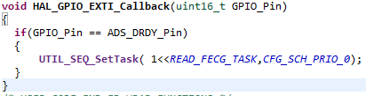

1.First is the interrupt handling function.
0693W00000SwDssQAF.png​The task performed is the function read_fecg().

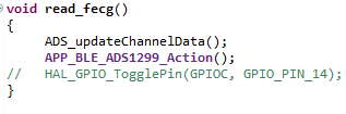

2.The second step is to run the function read_ fecg().
ADS_updateChannelData() updates ads1299's data.
HAL_GPIO_Toggle() controls led on or off.
APP_BLE_ADS1299_Action updates server notifications(ads1299 data).

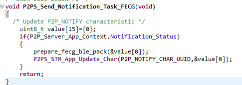

I found that the problem is on the function APP_BLE_ADS1299_Action().

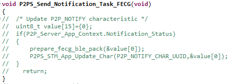

0693W00000SwG0ZQAV.png0693W00000SwG0jQAF.png0693W00000SwG0yQAF.pngFECG_UpadateMeasurement() executes P2PS_Send_Notification_Task_FECG().

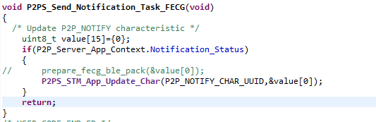

0693W00000SwG2aQAF.pngI found that even if I commented out all this function, it is still unsuccessful. :face_with_tears_of_joy:
1. Comment all, fail0693W00000SwGBhQAN.png2.Comment out the data to be transferred and only transfer 15 0 elements. The result still fails.
Why do I change from raising to falling and bluetooth doesn't work. :crying_face:
I speculate that it may be the scheduler, even if the task to be executed is an empty function(P2PS_Send_Notification_Task_FECG).Actually the scheduler will execute this function.
UTIL_SEQ_SetTask( 1<<CFG_TASK_FECG_EVT_ID,CFG_SCH_PRIO_0);
Is it possible that the scheduler polling will generate an error because I use falling edge?

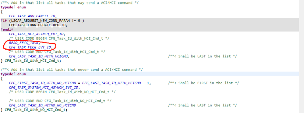

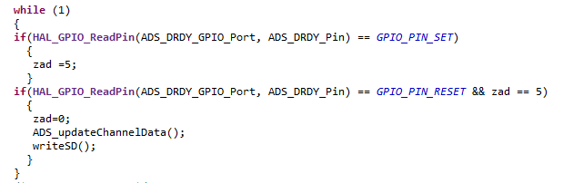

The ADS_DRDY signal (data ready signal) can be judged by the external edge interrupt method(HAL_GPIO_EXTI_CALLBACK) and reading the state of this pin(HAL_GPIO_ReadPin(ADS_DRDY_GPIO_Port, ADS_DRDY_Pin)).
For the second readpin method, how should I write the program?
Currently I only know about external trigger (HAL_GPIO_EXTI_CALLBACK) and virtual timer (HW_TS_Start), but I don't know how to read the AS_DRDY pin state and send notification program in the task scheduler (I don't think the above two methods are applicable).0693W00000SwKMeQAN.png
