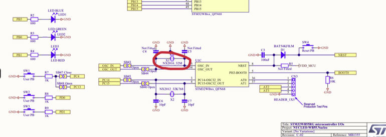

STM32WB55RGV 32MHz crystal part number based on NUCLEO-WB55RG
eesy-ES
we are looking for the right Part Number for a STM32WB55RGV 32MHz Crystal. On the NUCLEO-WB55RG evaluation board schematic, we see this part number, but every supplier offers a wide range of similar crystals but with different capacitances. We already have an issue with a similar ST device (STM32WBA55) design where we experienced issues selecting a different crystal other than the one in eval board. Could you point out the exact part number to be sure we use the same?

STTwo-32
Hola @eesy-ES
The exact Manufacturer Part Number for the X1 crystal of the NUCLEO-WB55RG is the "NX2016SA 32MHz EXS00A-CS06654" for the Revision D-01 of the board. All this data is available on the BOM of the board.
Adiós.
