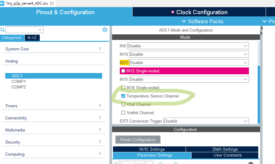

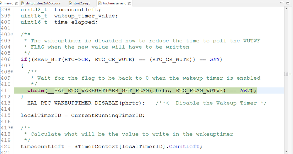

dungeonlords789
November 3, 2021
I also add ADC on temperature channel in project my_p2p_server4_ADC. Sometimes client doesn't see server. I pause debagger and see
"hw_timeserver.c" at line 411 (not 566 like @ZZou.1​ :(
    * Wait for the flag to be back to 0 when the wakeup timer is enabled
   while(__HAL_RTC_WAKEUPTIMER_GET_FLAG(phrtc, RTC_FLAG_WUTWF) == SET);
CubeIde 1.7, the firmware version is STM32Cube_FW_WB_V1.12.1
PCB is MB1355C
Without ADC temperature channel works without this problem.
