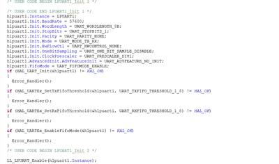

I configured LPUART with 57600 baudrate. With this baudrate configuration Rx interrupt stop working if I send more than 11 bytes of Data on UART. With the same configuration there is no issue in transmit. Also in receive if I send less than 10 bytes then it's working without an issue but if number of bytes increase RX interrupt stopped.
Then I configured LPUART baudrate 9600 and in this case everything working as expected.
So, Can you please let me know that LPUART can be work on 57600 baudrate or not?
Also please share the configuration to make it work on 57600 baudrate.

Thanks for the reply, here attached the lpuart config and callback

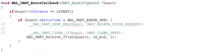

Meanwhile I also tried to debug more to fix this issue and found that after 11th byte it continuously receive Overrun error and because of that Rx interrupt not working. To fix this issue I have added following callback .
After adding the error callback, disable Rx interrupt issue was fixed but I received the data loss on uart.
Can you please guide me a right way to fix this overrun error and data loss issue?

You're not checking HAL status. So when your call HAL_UART_Receive_IT and it returns HAL_BUSY, then interrupts is never enabled for that huart, ever. Test for the return status and set a flag if busy. Then in main while loop check the flag and then call HAL_UART_Receive_IT again.
if(HAL_UART_Receive_IT(&hlpuart1, pData, Size) != HAL_OK)
			// set error flag. Check error flag in main while loop and try calling HAL_UART_Receive_IT again.

As per section 2.15 of the ES0394 I tried to Increase the LPUART kernel clock frequency, still facing an same issue on 57600 baudrate. I already tested with lower baudrate configured as 9600 and everything working.
The module which I'm going to use with stm32wb communicate on uart with 57600 baudrate. Can you please help me to solve this?

At higher rates it depends on the peripheral source clock (APB ?) and the error in the desired vs achieved rates.
Check for sticky noise or framing errors reported by the LPUART with regard to reception. These will need to be cleared.
