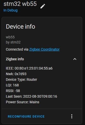

Hello, I'm trying to make a Zigbee application for a battery powered device (currently using the ZHA integration on Home Assistant) and I am having trouble to set the attribute for a battery power source, (it seems to be stuck on the default of Mains), however setting the manufacturer and model strings are working.

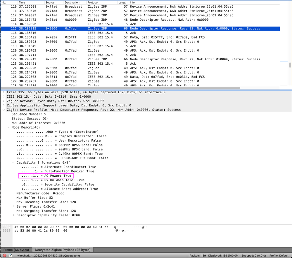

Even after changing the Basic cluster Power Source attribute, the issue in Home Assistant still remains; the Node Descriptor is still reporting that the device is mains powered.

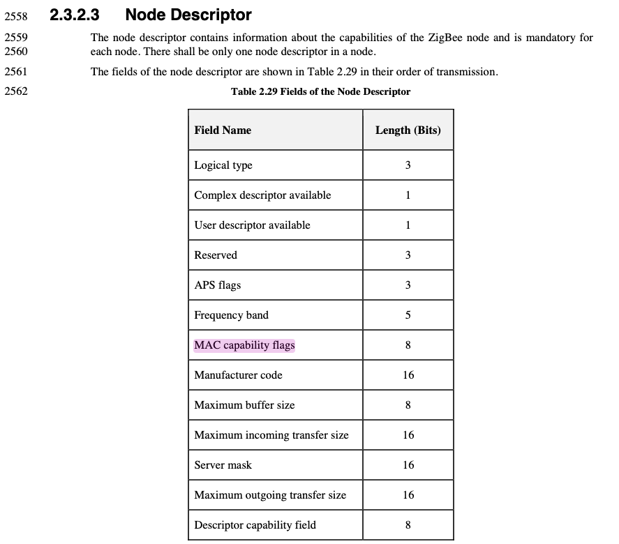

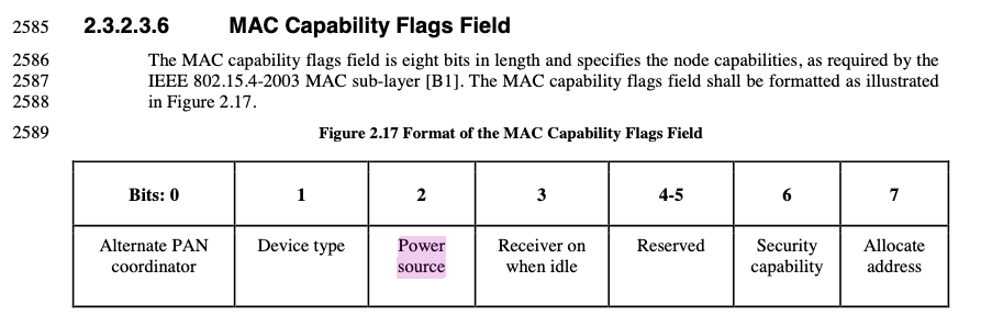

Is it possible to edit the Power Source bit in the Node Descriptor MAC Capabilitiy Flag per the table from the zigbee standard? Thanks
earlish
If anyone else come across this thread and is interested, I was able to change the node descriptor with the following line of code:
config.capability &= ~(MCP_ASSOC_CAP_PWR_SRC);
