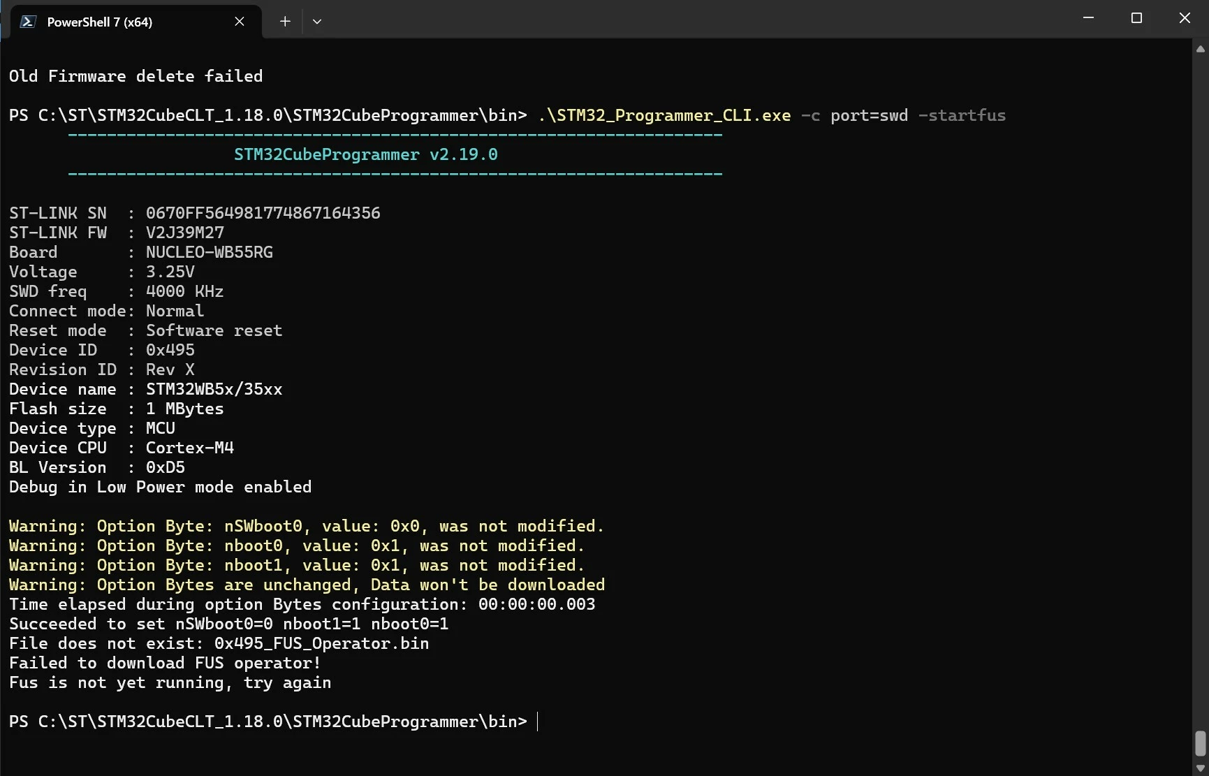

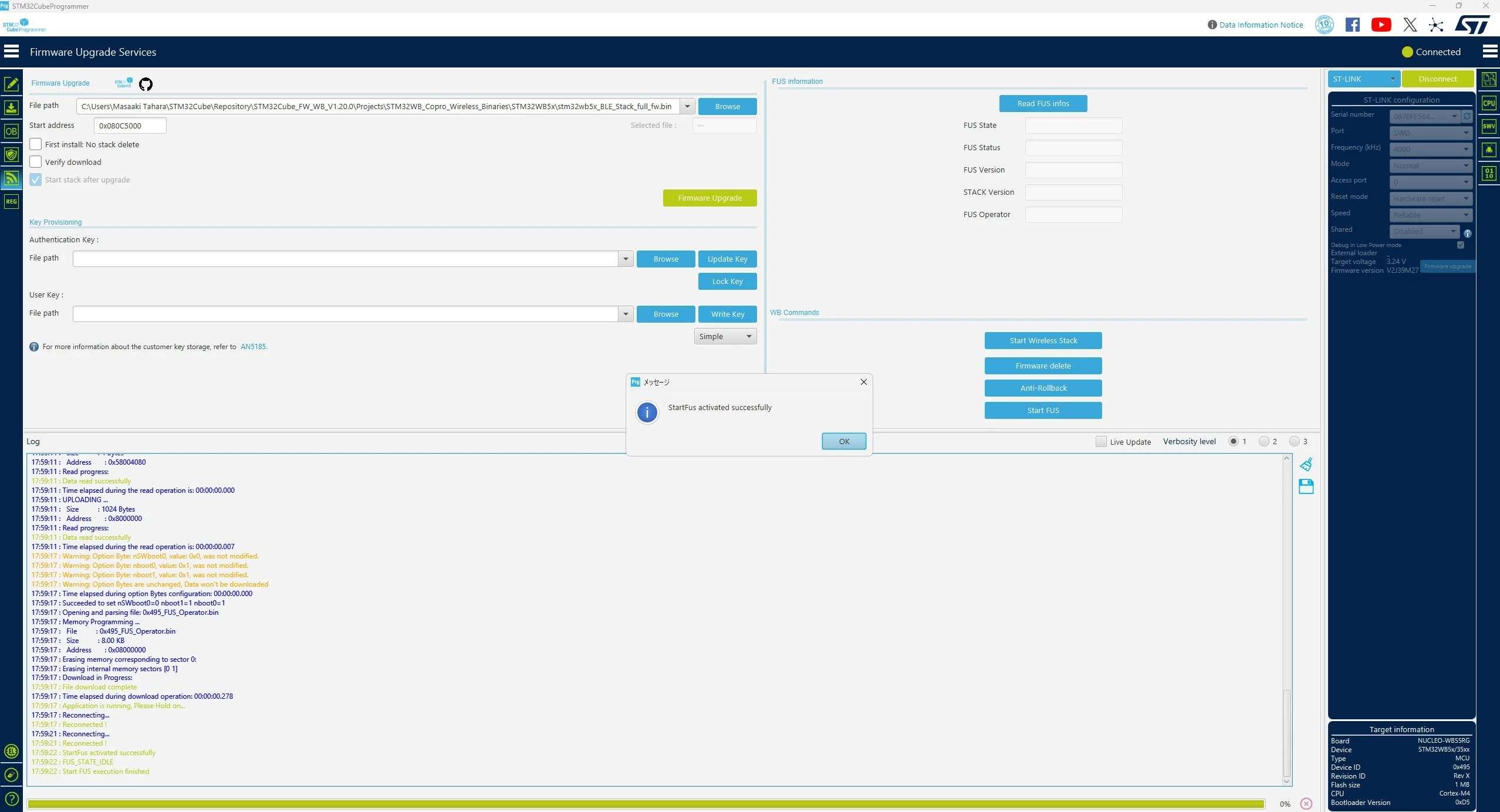

If I tried to connect Nucleo-WB55RG with CubeProgrammer GUI and CUI to update wireless stack using swd connection, the behavior of each was different.
I could start FUS and update wireless stack on GUI, but cannot start FUS and update wireless stack like picutures.
I just followed how to flash on STM32WB_Copro_Wireless_Binaries/STM32WB5x/Release_Notes .
What is difference or what is wrong on CUI update?
If I tried to use FUS on CUI, always asked "File does not exist: 0x495_FUS_Operator.bin" as error message.

Hello @mtahara and welcome to the ST Community.
I suggest you follow the answer to the question " What is a typical STM32CubeProgrammer command to perform an upgrade using FUS?" on the table 23 of the AN5185. Also, you should use the chapter 3.2.22 of the UM2237 for more details.
Best Regards.

mtaharaAuthor
March 14, 2025
@STTwo-32
If I tried following your instructions, I could run FUS and update wireless stack by using Programmer CUI commands.
Thanks for your kindly support.
