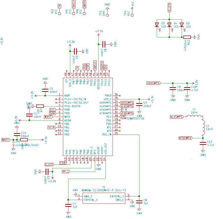

I'm working with a custom STM32WB55CCU6 board I've created. I made it to where the only interface is the SWD PA14/PA13.
I'm 99% sure my schematic is fine as I used the STM32WB design guidelines and sample schematics as my reference. (BOOT0 - Tied to ground with 10K resistor, NRST tied to 3.3V with 100K resistor and 100nF cap in between).
I'm using a 32MHz crystal.
Here is my schematic.
I'm using a generic STM-LINK/V2 with firmware version V2J37S7.
I'm connecting 3.3V, GND, SWCLK, SWDIO, and NRST to the STM-LINK.

ST-LINK Utilities is deprecated, use STM32 Cube Programmer.
Most issues are caused by Connectivity or Power, an un-powered scan chain isn't going to function. Check state of NRST pin, check power supply, look at with scope.
Code on device using LOW POWER or STANDBY type modes?
Should VDDRF be powered?

Thanks! I'm trying to utilize the Cube programmer as well, but that is freezing as soon as I click "Connect"
I have a feeling the issue is VDDRF... Looks like that powers the HSE which the STM32WB is reliant upon... It's weird because my oscilloscope is showing the SDWDIO interface working without the ST-Link connected.

What would alternative uses of SWDIO/SWCLK be in a normal application of the IC? They are general GPIO, and if they're are reconfigured early in the post-reset code this can block connectivity within the thousands of cycles needed for control to be wrestled by the debugger.
Also NRST has to make it to the debug interface for "Connect Under Reset" strategy to be viable.
Pulling BOOT0 HIGH can take user code interfering with the interface out of the question

There is no usage for them outside of SWD.
I tried connecting NRST to the debugger and pulling BOOT0 high to put it in DFU mode. None of those solutions worked.

Update: I ran a jumper from 3.3V to VDDRF. Still not working. Double checked on my oscilloscope and SWDIO is definitely outputting signal
Does CubeProgrammer work with the generic ST-Link-V2 modules? When I click "Connect" nothing happens.
