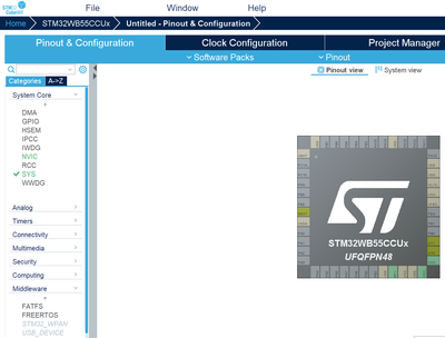

So, the STM32_Touchsensingis a middleware that can be used with some STM32 MCUs. So, all you have is to open CubeMX, select an MCU or a board that you are going to use (as i can see is an STM32WB) and start your project. On the configuration panel of CubeMX m, go to middleware and enable the STM32_Touchsensing (you lay also have some settings to do for the middleware parameters).

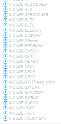

Hi there, I do not see an option to enable touch sensing for this MCU. It does appear to automatically be there for the
STM32F072RB MCU though.
Is there something I need to configure in order to get it to appear?

It should be under middleware. It may be garyed. If so, please put you cursor on it and a message that tell you what you have to do before you can enable it.
Dont forget to use the last version of CubeMX (V6.12.0).

never mind, the STM32WB55CE does not have touch sensing capabilities.
