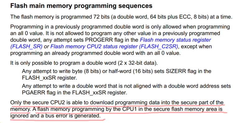

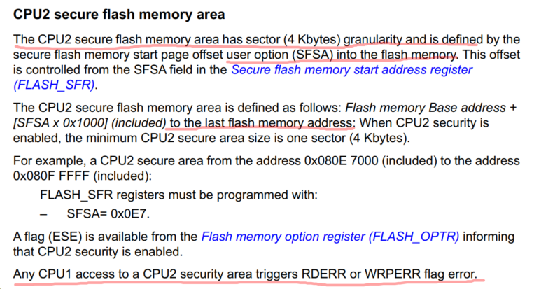

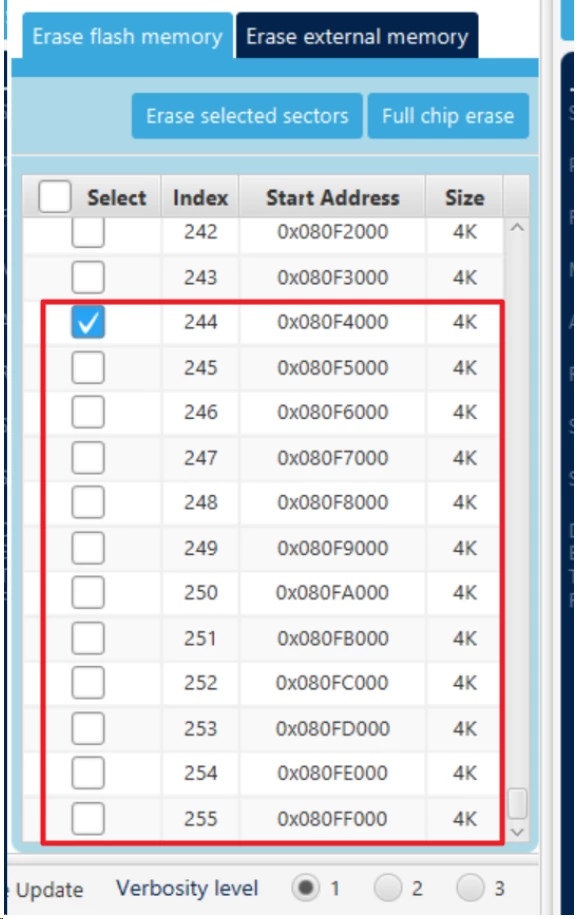

Hi.
Something that needs to be done FOTA while using the code, so you need to write the flash area behind it.
I want to use a sash area, but it is impossible to access the document.
Please tell me if you have a way to do it.

I wanted to flash write in the WirelessStack area, but I gave up because I found it impossible.
