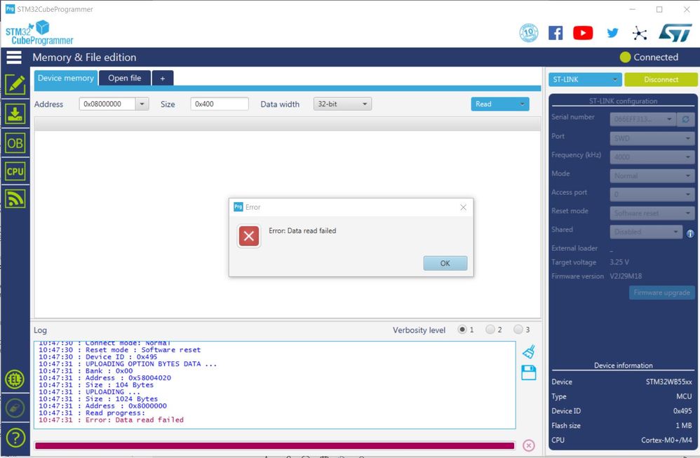

Kalpesh1
STM32 Cube Programmer Utility :
Snapshot of Error STM32 Cube Programmer : Connect event

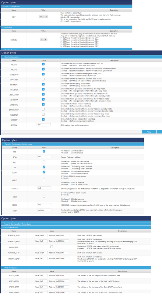

I am able to read option bytes:
0693W000006FaFQQA0.pngBut I am not able to erase or download

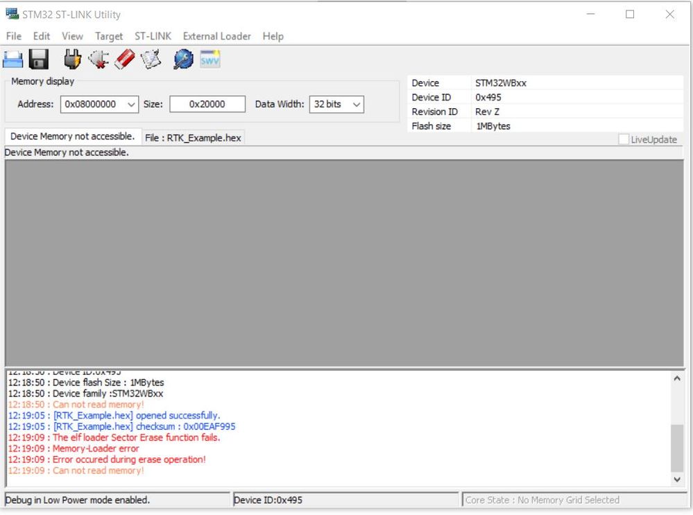

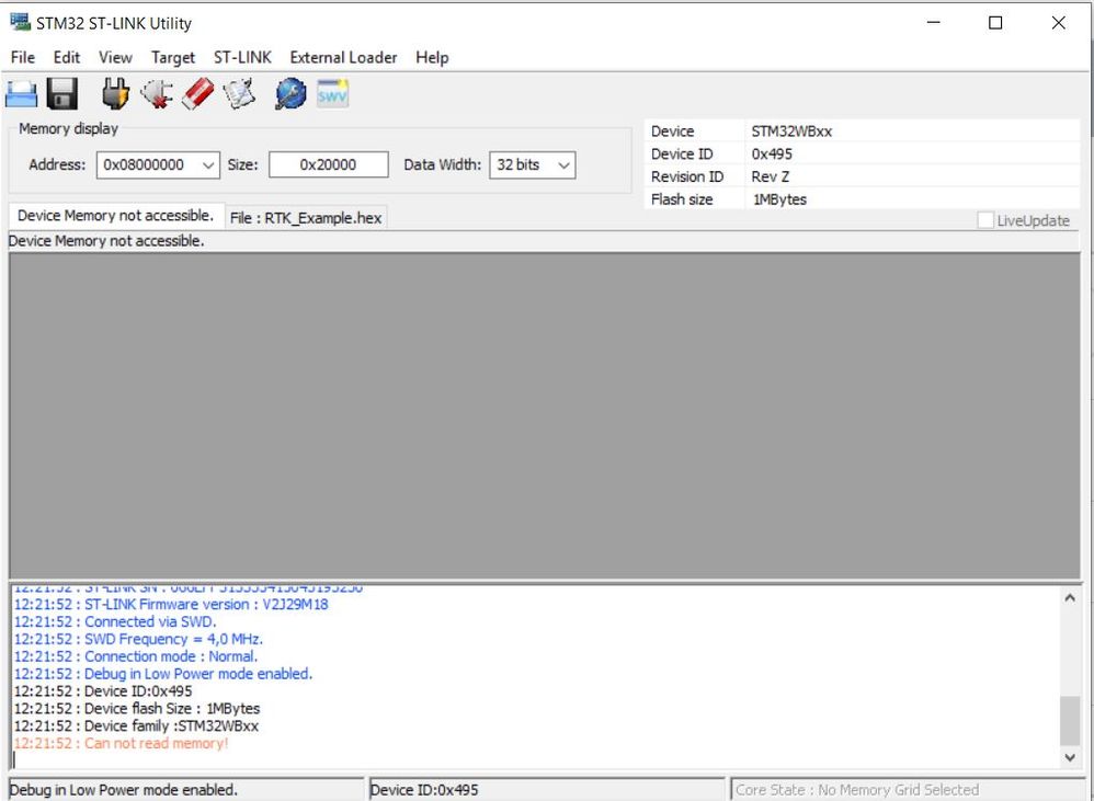

Kalpesh1
STLink Utility :

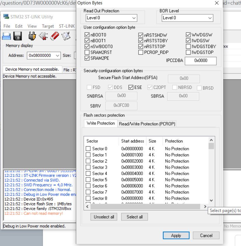

Able to connect but getting read error :
I am able to read option bytes :
0693W000006FaQEQA0.jpgError in erase and download :0693W000006FaQiQAK.jpg
