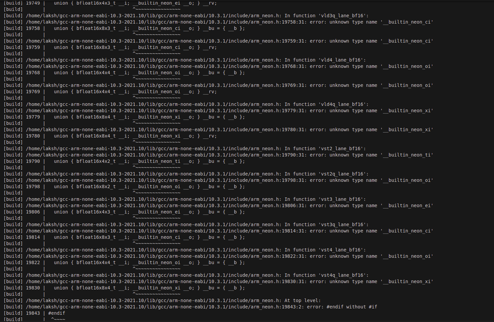

I have been trying to add opus codec in my project. But I cannot able to build after adding the opus file. If anyone successfully added opus with their project help me out. I mostly get errors on 'Neon' which is used for FFT. As I searched neon is for cortex A, but the STM32WB5MMGHTR is cortex M based. I'm also adding my config file code for opus here

I'm having the same problem. Did you find a solution?

No I couldn't find any solution. May I know what kind of error you are facing exactly.

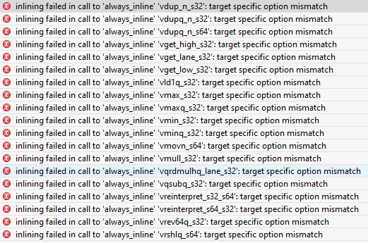

Hi LR.2,
My error outputs are like this but I couldn't find a solution.
Thanks & Regards

Hello All,
It looks like there is a missing file (.pdsc file =Pack Description Format) in the he folder "X-CUBE-OPUS.zip.
Our team are working to resolve the issue.
Thank you for your feedback and sorry for the inconvenience.

I integrated opus in my project.
Things I did:
1. I opened example project which present inside the "X-CUBE-OPUS.zip" and explored what are the files included from the opus library. To check this I read ".cproject" and ".project" from the example file, then I added those files in my project.
2. After that I checked the compiler options from the project build settings and I made changes in my project compiler options with that.
3. Also, I checked build output for "fpu" based compiler options and set in my project. Opus needs "-mfpu=fpv4-sp-d16" "-mfloat-abi=hard" options to get compiled. (Before adding this option verify your controller has support for FPU).
After all the above changes in my code I got compiled successfully.

Hi Laksh,
I am getting similar errors. Can you add the ".cproject" and ".project" files of your project here so I can compare?
