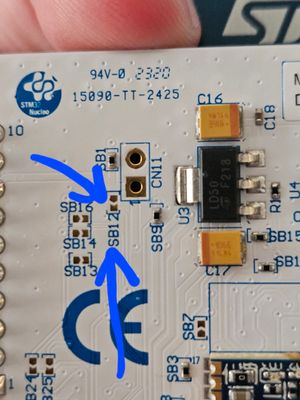

If I realize it is true, is it needed to solder SB12 in NUCLEO-WBA52CG board for using SWO as ITM_SendChar in printf debug?
Thank you for helping!

I think it is a miss understanding from my side. You should solder the SB12 so you can use the on board SWO throw the on board ST-LINK.

The SB12 need to be soldered if you are going to use GPIO32 (Pin 10 of the CN4) as SWO.

And for using via embedded ST-LINK in the board, is it still required?
I ask because the ITM printf isn't working and after checking CAD resources for it.
If you are using the on board ST-LINK, you don’t need to solder the SB12.

I think it isn't working beacuse the SB12 that isn't soldered...
As I have seen in CAD files, pin 10 in CN4 connected without SB12:
Hello @Arielu
