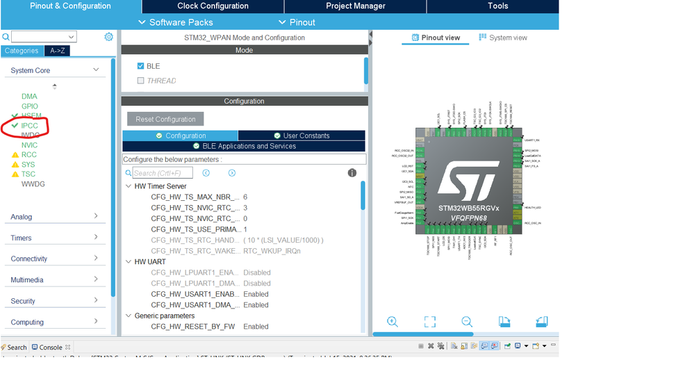

I am trying to configure Bluetooth on STM32WB5MMG Module, but iam not able to find IPCC option in CubeMX.Please help me out.

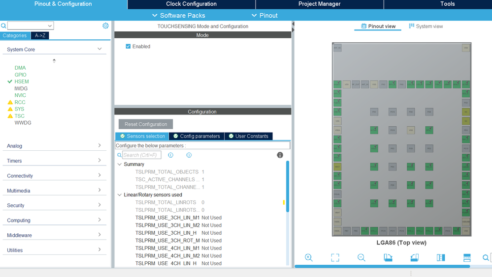

Like while configuring for STM32WB55 board...we get to enable IPCC in cube MX...But while configuring the same for STM32WB5MMG Module the option is not availble in cubeMX...may i know what is the issue​
0693W00000Czq7YQAR.png0693W00000Czq8HQAR.png Here in the first image for STM32WB5MMG Module the option is not availble in cubeMX...but while configuring for STM32WB55 board...we get to enable IPCC in cube MX

What is the CubeMX version used?
Version used is same (Version: 6.2.1-RC2) in both the cases.
Remi QUINTIN
Indeed, the issue is confirmed with 6.2.1. This is issue is solved in version 6.3.0 that should be released very soon.
