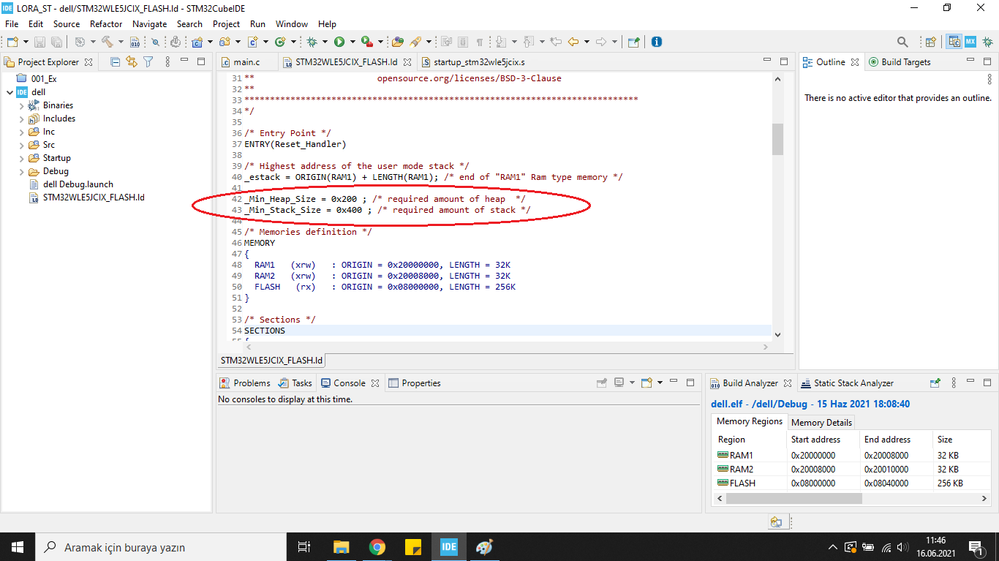

Hi ,
Default values of the _Min_Heap_Size and _Min_Stack_Size is setting according to What? I changed these variables from 0x200 , 0x400 to 0x00 and 0x00 resprectively ,end then no problem,no error .I guess that Static and dynamic variables in RAM are in the RAM Base Addr + (_Min_Heap_Size or _Min_Stack_Size ) . Why are they 512 byte and 1K byte as default?
Best regards,
Enes.
Why anything? They are what they are, change them to what you need. Those are the defaults in the linker template file. The code generator doesn't do any sort of smart evaluation of your project needs and set them according to that, if that's what you're curious about.
Note that these just ensure the space is there. Setting them to a value that clearly won't work (i.e. stack size of 0) won't throw an error.

I can't understand what these (_Min_Heap_Size and _Min_Stack_Size) default values are respect to. The Values of an another ST MCU which has a different RAM size are different others, for example instead of this:
_Min_Heap_Size = 0x200 ; /* required amount of heap */
_Min_Stack_Size = 0x400 ; /* required amount of stack */
like this:
_Min_Heap_Size = 0x100 ; /* required amount of heap */
_Min_Stack_Size = 0x200 ; /* required amount of stack */
If I need to ask for you more clearly , Are These DEFAULT values chosen randomly or else is there a special reason?

That would do something different. It would place it at the end of the used space, but not at the end of RAM (unless you were using 100% of RAM). But if that's what you want, do it.
Neither.
