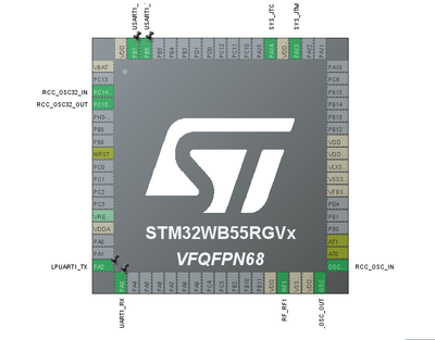

I bought P-Necleo-WB55 and I could see the ioc files for some application examples, however, the ioc file and code are not matching, for example the BLE_p2pClient application shows this .ioc file.
and the schematic shows many other pins are used. Why the FW code and ioc file are not matching?

Hello @YJ99
the Zigbee project may be a lot different from the BLE one. Could you give more details.
